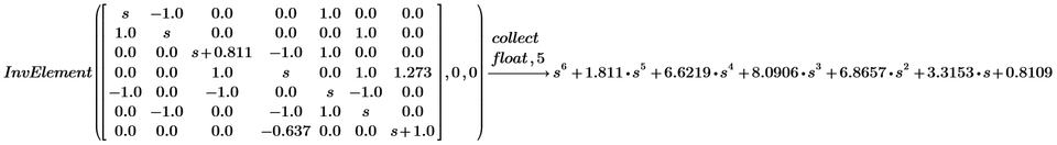

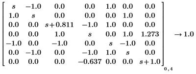

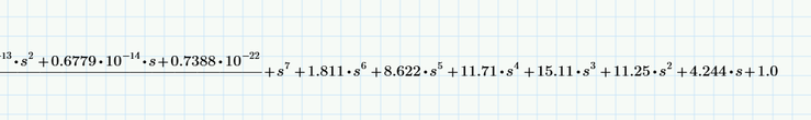

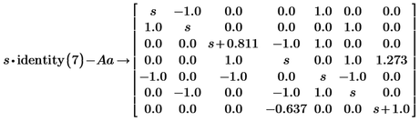

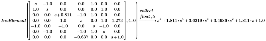

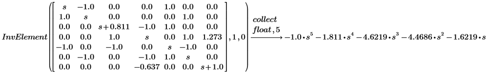

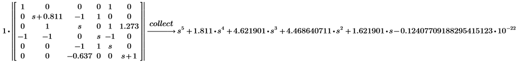

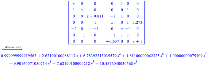

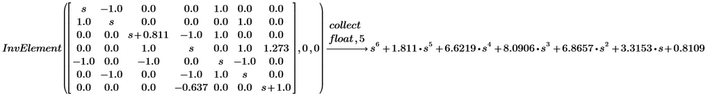

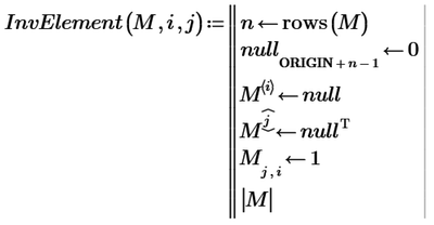

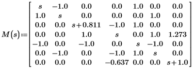

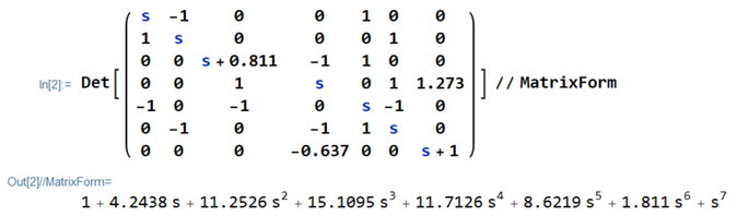

Determinat of a Matrix Mathcad Prime 8 Strange Result

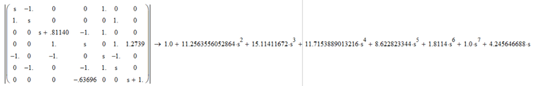

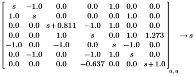

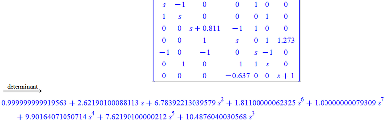

Mathematica result:
Maple result:
Mathcad 11 result:
Mathcad 15 result:

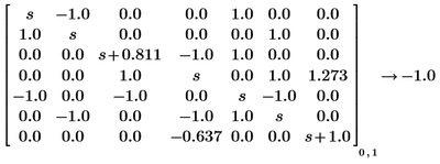

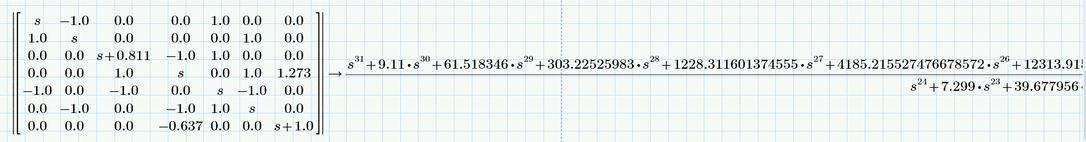

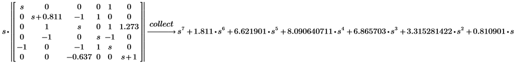

Mathcad Prime 8 result:

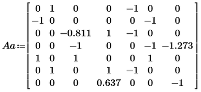

Why does Mathcad Prime give such a result when calculating the determinant of that matrix? Is this some bug from prime? or?
Mathcad Prime 8 file attached.

In Maple you have a typo - first row, second column
Cornel19-TanzaniteAuthor
Jan 23, 2023 1:09 PM UTC
Did not influence pretty much...
Anyway, strange how Mathcad Prime calculates this determinant...

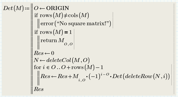

Jan 24, 2023 2:20 AM UTC

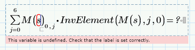

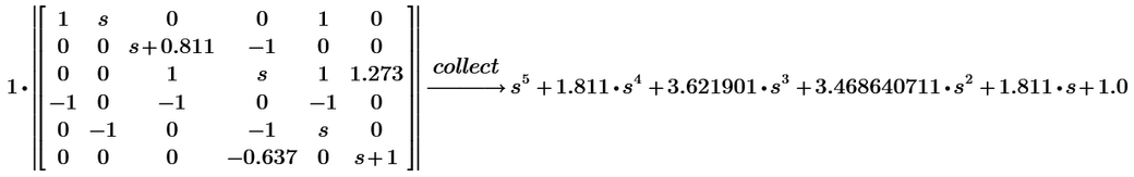

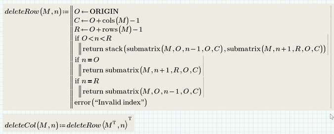

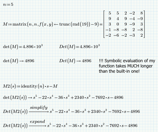

Here is my attempt for a function to calculate the determinant of a square matrix.
First we define utility functions to delete rows and columns of a matrix
Then the determinant is calculated by Lagrange expansion after the first column - done recursive until we arrive at an 1x1 matrix
I haven't tested thoroughly, but it seems to work quite well, BUT ... its VERY SLOW when evaluated symbolically!!
Furthermore something like "simplify" or "expand" is necessary as otherwise the result isn't really nice 😉
Have fun and use at your own risk!
EDIT: Added an alternative function to delete rows (and columns) which avoids the slow "submatrix" function but it did not speed up the calculation.
