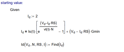

I am trying trying plot the I/V curve on the graph of the diode model, having as example from "Simulation on Mathcad the SPICE Model of the Diode Dmbr2045mfs.pdf" by Pedro Vitoriano.
an somebody help me?

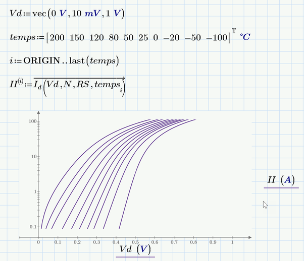

Concerning the plot you would have to use a log scale on the y-axis and manually type in 0.1 and 100 as lower and upper limit.
The result nonetheless does not match exactly the picture you posted. So either other input values were used or other formulas.

Besides the brackets, the scalar variable and function Id are the same?
Either use the Math | Style | Labels to define the appropriate definitions of variable and function to each instance of Id.
Or use different names for the variable and function.

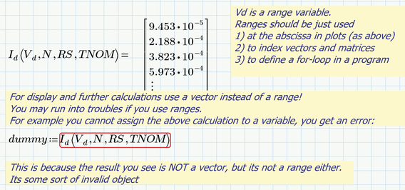

2) In you solve block you wrote IS(t), but IS is a constant scalar (0.0003) and not a function. I guess you meant Is(t).

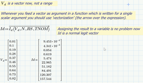

3) For plotting its better to use range with smaller increments to get a smooth plot
4) For displaying values and possible further calculations with them you should not use ranges but rather vectors! See my comments concerning the creation of the vector in the attached sheet.
Prime 9 sheet attached

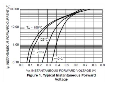

The final graph it should look like this or at least this was my end results looking for:
Nevertheless thank you for you response and help
Here a pic from the version with units which I posted
or using a waterfall plot
