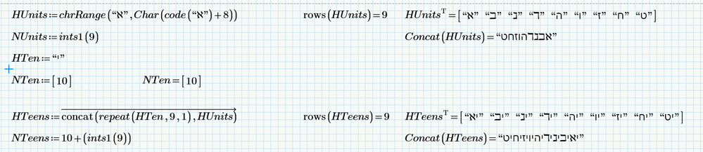

I'm brushing up on my Mathcad Express skills by writing a Roman-to-Arabic number converter, and thought I'd try generalising it slightly to encompass similar sign-value systems (eg, apostrophus and extended subtractive Roman numbers, and Hebrew numerals).
Mathcad's Unicode range does, however, support Hebrew (and Japanese).  I can programmatically create Hebrew strings ...
... However, I'm having a problem trying to paste Hebrew text into either a variable name or (of particular interest) strings - nothing happens.  Text Box, no problem.
Hence, the title of this thread: how can I paste Hebrew text into a Mathcad string or variable name?

I had no problems copying Hebrew characters from M$ charmap directly into a Prime string, nor experienced I any problems in creating a variable name from this string by deleting the quotes:

Sorry, I didn’t see your reply, at first, Werner because I was busily reporting that I’d also managed to paste Hebrew text as names and strings

A little bit more playing makes me think the problem might be related to similar issues that have popped up over time when Mathcad doesn't like certain characters being pasted into regions.  Werner ( @Werner_E ) posted an example recently in https://community.ptc.com/t5/Mathcad/Problem-Report-newline-character-no-longer-works-in-a-string/m-p/1035492/highlight/true#M218890.
I've managed to copy and paste constructed strings into Mathcad (after removing the quote marks😞
I've tried pasting the external text into the Find box, then copying it back again and pasting it; still no joy.
