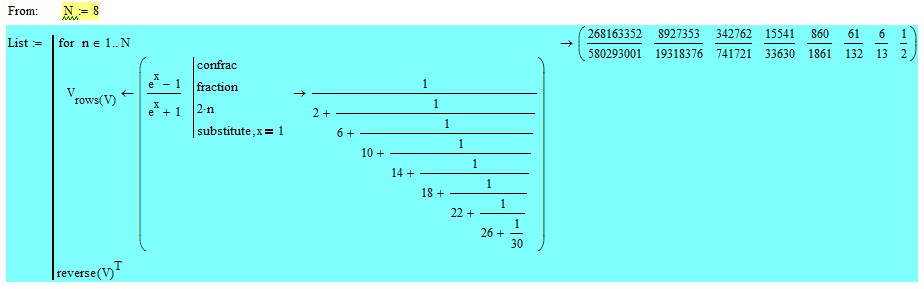

Hello Everyone.
Thanks in advance for your time and help.
Regards.

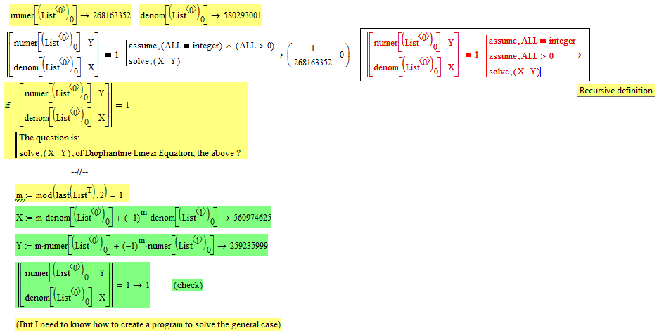

April 12, 2021
The determinant gives an equation with two unknowns. However, if I add another one relating to the next ratio, I obtain a non-homogeneous linear system of equations in the unknowns X and Y, of which there is a solution. What do you think?

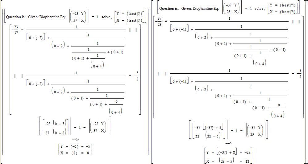

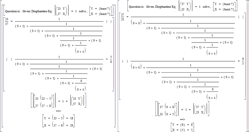

April 12, 2021
Thanks for your time, MFra. I guess we should consider something about: 1.png . Copy and paste your screenshot, it seems look like the following:

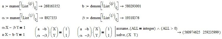

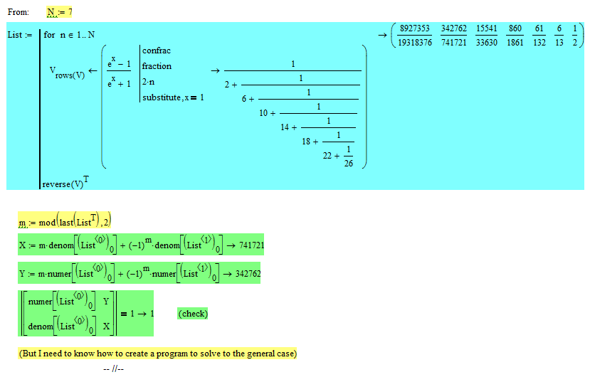

April 12, 2021
I know it's not the answer you are looking for, furthermore, some are negative and aren't diophantine solutions, but it's already something ....
Instead of defining a linear non-homogeneous system of equations with constant coefficients in two variables, in the same way, one should define such a system in N equations in N diophantine unknowns. I don't know if that's possible.
