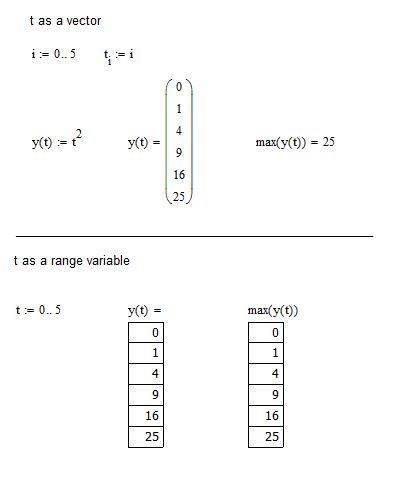

a example
y(t):t^2  wit t = 0..5
max(y(t)) does not return 25
Make sure t is a vector not a range variable:

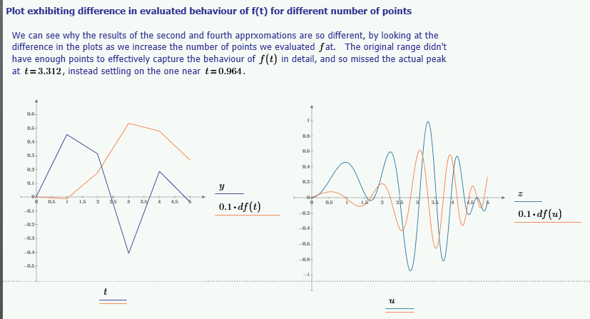

You need to be careful how many points you evaluate a function over when looking for its maximum within a given range.
If you don't have enough points, you will not likely get the prize of picking the right maximum or even seeing most of them.
Here's the difference between 0..5 and 0,0.01..5.  Quite different beasts.
