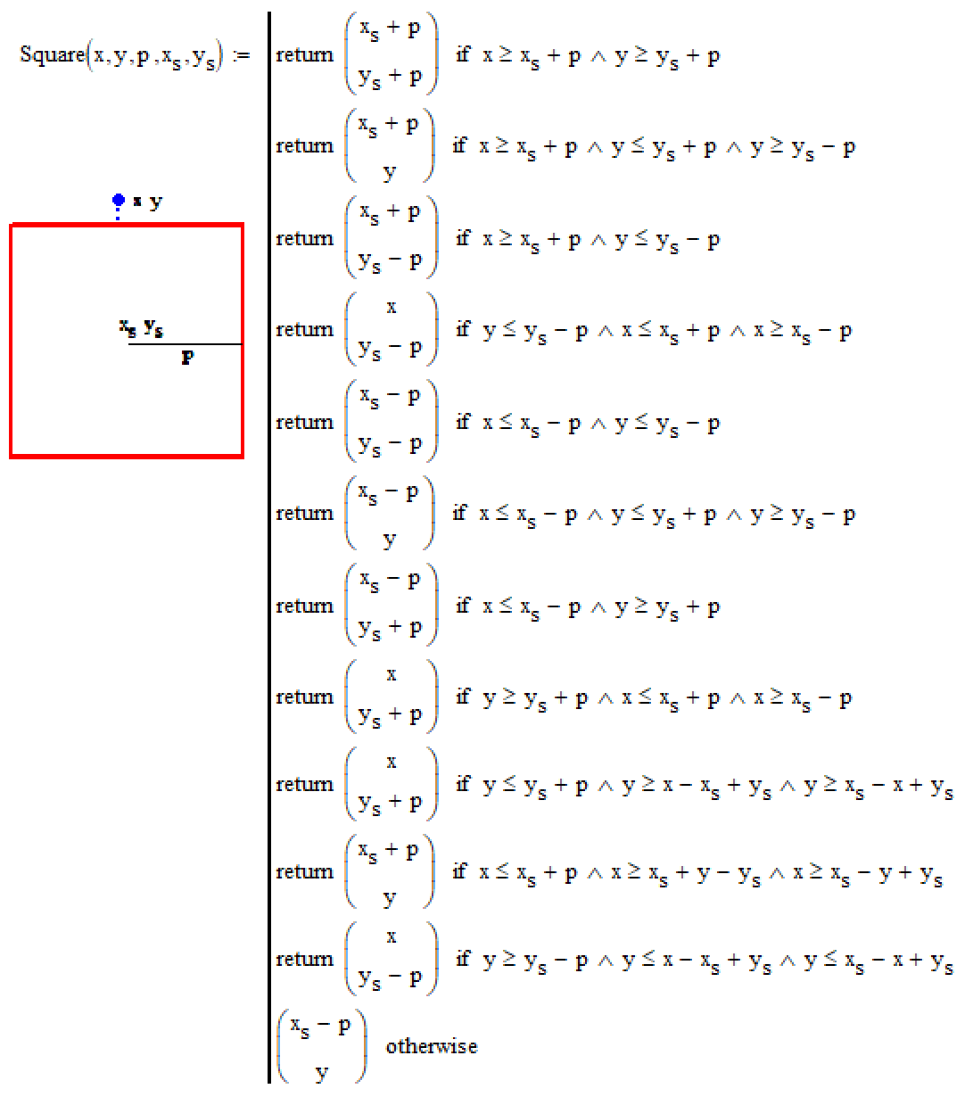

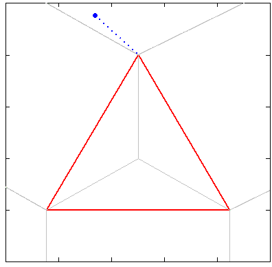

I have a function for the calculation the distance between a point and a square.
See please the animation and the Mathcad sheet in attach.
My questions:
0. Do you know some references on this topic - an ellipse with not point-focuses but with circles etc?
1. Can the function Square be mote simple?
2. I need one more argument for the function Square - an angle alpha - the rotation of the square from 0 to 90 deg.
3. Help me to create the function Triangle (Rhombus, Rectangle, Ellipse, etc.) with same properties!

Not an exact solution, but this is close.  I divide each line into segments and pick the closest of all the points. 4.0 and pdf attached.

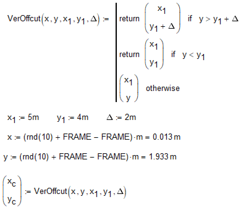

One simple example - a vertical offcut.
Wee need an angle alpha in the function OffCut!

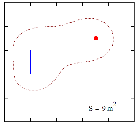

See one animation of new Ellipse

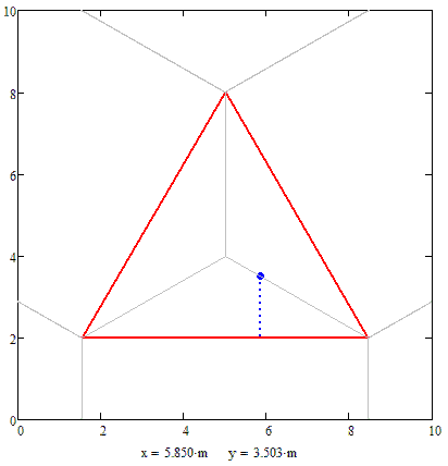

A equilateral triangle

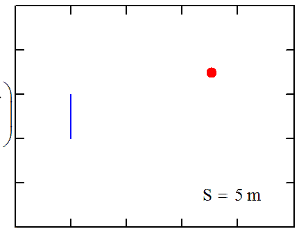

More correct function and animation:

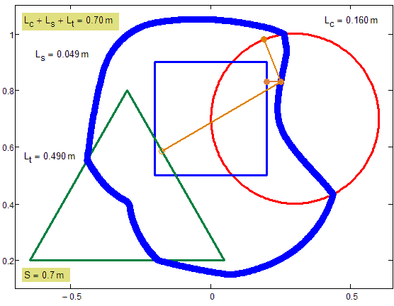

An Ellipse with a circle, a square and a triangle as focuses:
