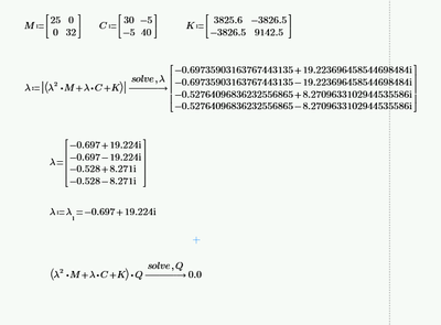

Dear all,
I re-substitute one of Eigen Value back to Equation (Q^2*M+Q*C+K=0) but get Q=0.
How can we calculate Eigen Vector (Q) after we know Eigen Value?

function eigenvec() can not use in equation form: Q^2*M+Q*C+K=0 use only vH · M = z · v
You can find the solution of this problem
here
