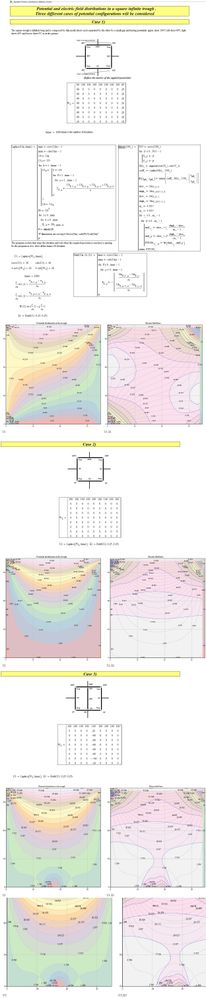

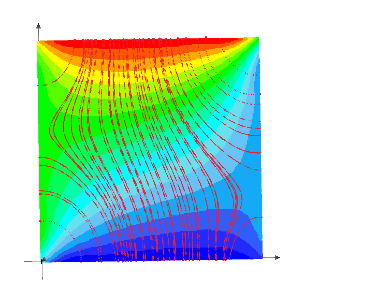

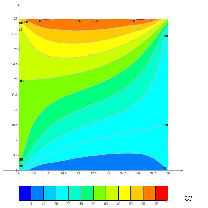

I have a graphics problem and that is: after having determined the equipotential lines (see photo) in a system with a square section and infinite length, made up of metal plates isolated from each other and at different potentials, I do not know how to make the field lines orthogonal to those of the potential. I have fixed two constant values ​​for the increments dx and dy. I attach the worksheet:

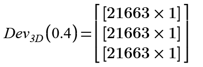

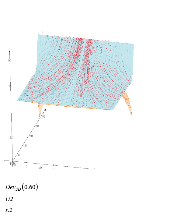

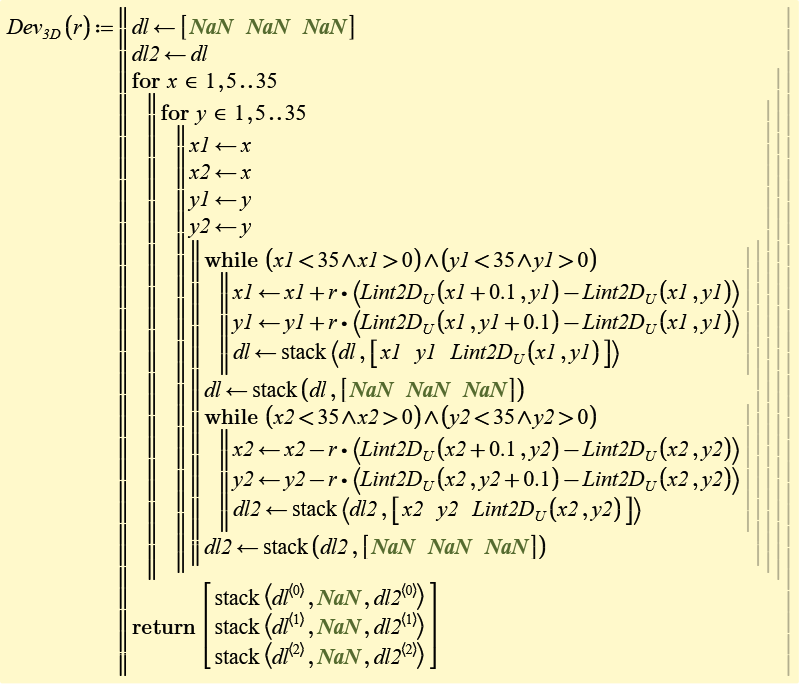

Step 1. Make interpolateed data.
Step 2. Trace the field line on the potential 3D plot. It need time for me to solve.
