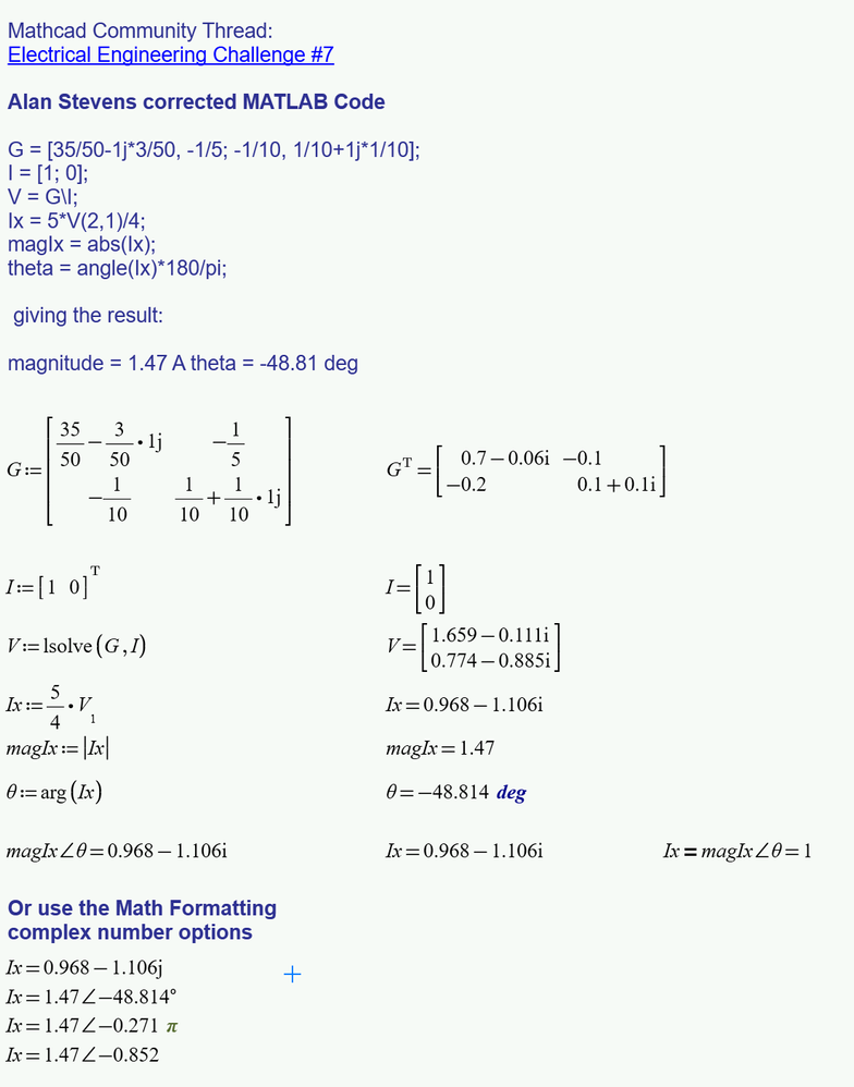

AlanStevens
(To:ttokoro)
The Matlab instructions don't reflect the problem correctly! They should be:
G = [35/50-1j*3/50, -1/5; -1/10, 1/10+1j*1/10];
I = [1; 0];
V = G\I;
Ix = 5*V(2,1)/4;
magIx = abs(Ix);
theta = angle(Ix)*180/pi;
giving the result:
magnitude = 1.47 A theta = -48.81 deg
Alan

Oops!  Forgot to add the simple way of doing it ...

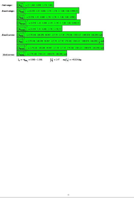

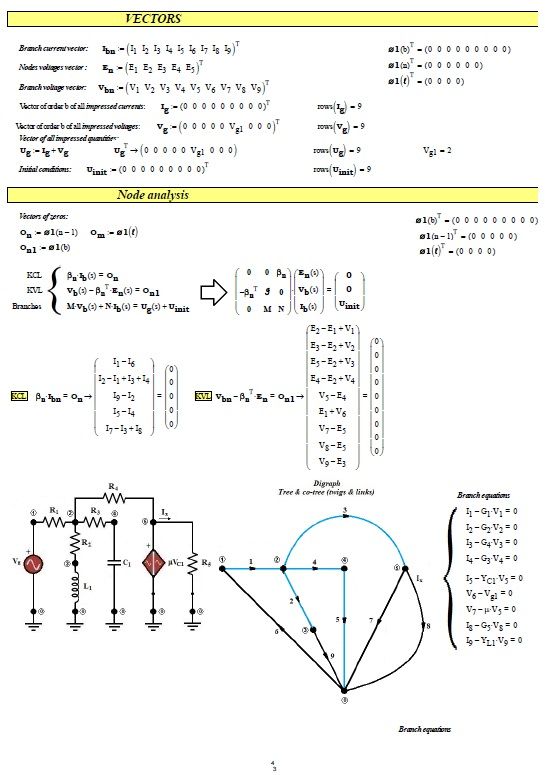

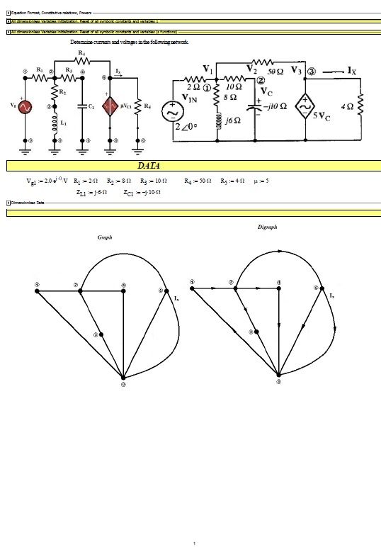

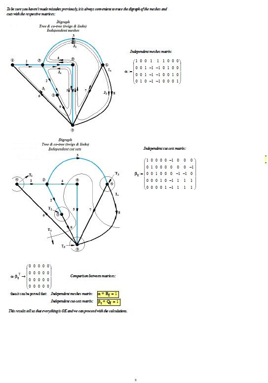

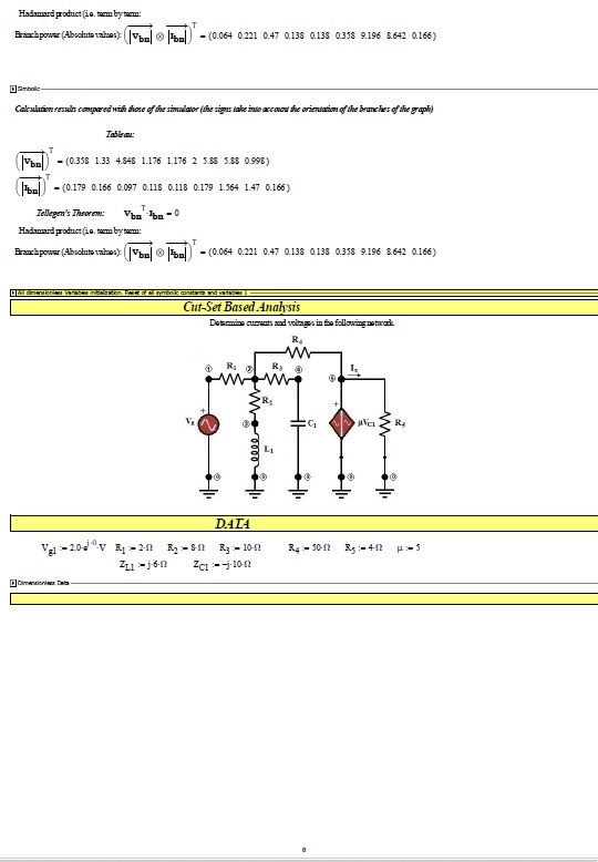

(To:ttokoro)
The circuit was interesting, so I analyzed it by applying the results of network topology. Having defined the branch equations and the  node voltage vectors as well as the branch voltage and current vectors, I applied the method of node voltages. I obtain the same results by applying the analysis method based on independent meshes and the method based on independent cutting sets. In the following photos there are all the calculations:
Challenge #7 1.jpgChallenge #7 2.jpgChallenge #7 3.jpgChallenge #7 4.jpgChallenge #7 5.jpgChallenge #7 6.jpgChallenge #7 7.jpgChallenge #7 8.jpgChallenge #7 9.jpgChallenge #7 10.jpgChallenge #7 11.jpg
