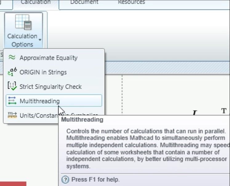

Try turning off multithreading calculations
Hello Terry,
thanks for your advice, but switching off multithreading doesn't work.
