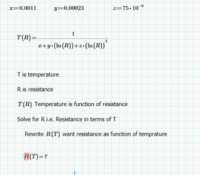

  1. T(R) -> Temperature is a function of resistance.  Therefore, if I want to find out a Temperature at a specific Resistance you can plug in a value of 10 kohms and get a corresponding value of Temperature -> degrees C.  -> This is Given.
  2. 3 Constants are provided and fixed.  They are givens.
Goal -> Rewrite T(R) Equations so that Resistance is a function of Temperature -> i.e. R(T) := ???????
I would like the equation in a format where I plug in a temperature and get a corresponding resistance.
Again I am looking to rewrite T(R) as R(T):=
Can somebody help

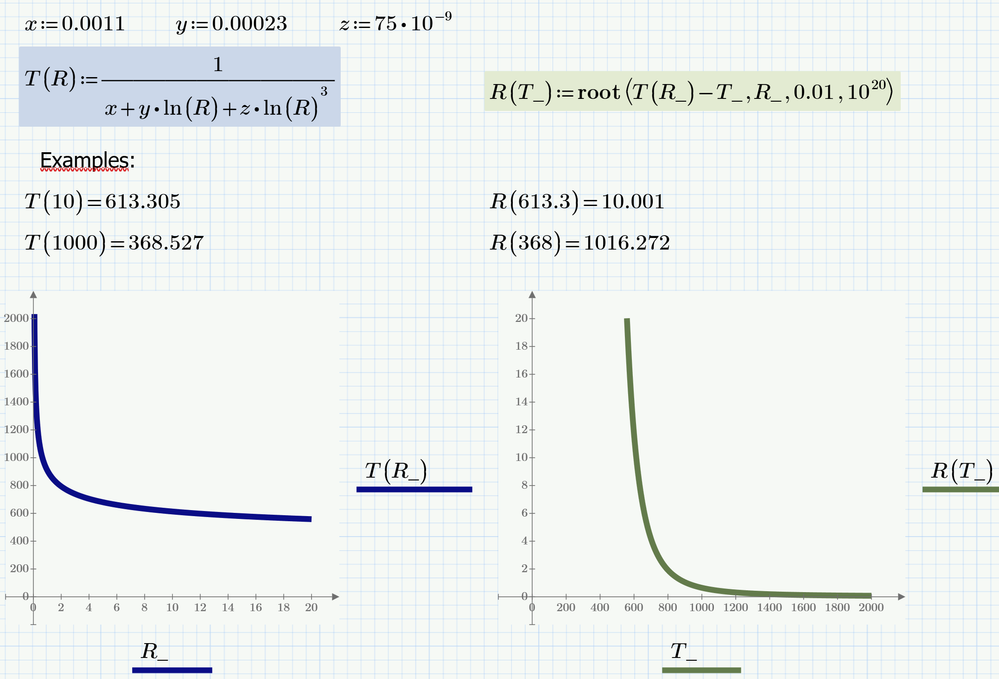

You may use a solve block or the "root" function.
The names T_ and R_ were chosen for the function arguments (and later for the abscissa variables) to avoid conflicts with the name of the two functions. Feel free to change them as you think is appropriate.
P6 sheet attached
