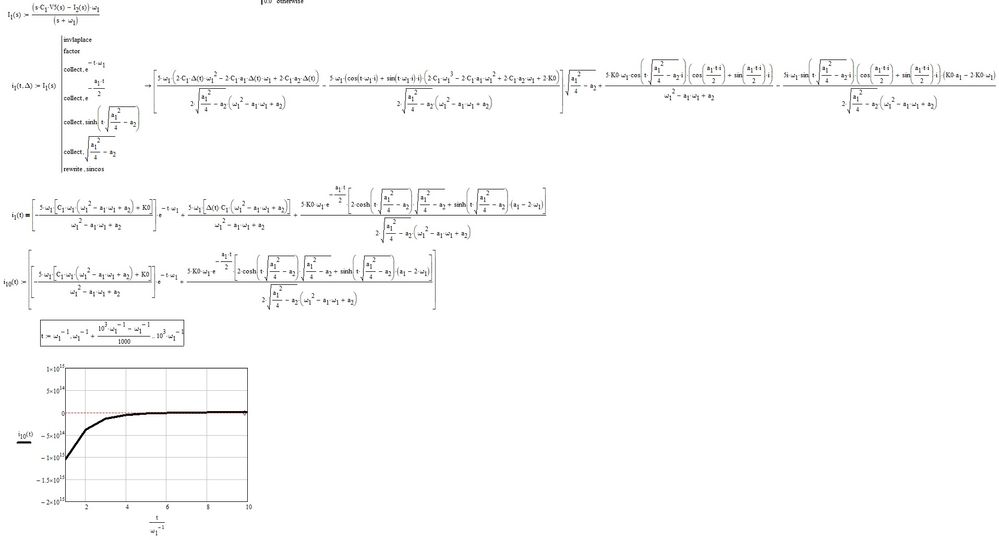

I encountered an error when I tried to plot a graph including arguments (t and Δ(t)). The error says:This function has the form:f(f(Unitless)->Unitless)->Unitless, but must have the form:f(any1)->any2. I have attached the file. Can anyone help me out? Thanks a lot.

Your function i(t,delta) is the problem--you don't have a variable delta, delta is required to be a function of time
Can you evaluate this function for any single set of parameters?  i(1,0.01)=

Anyway, I threw the delta function out:
Now the error is an overflow.

Symbolically evaluate the delta function for a couple of parameter values, and observe the results. Make sure one of the values is 0...
For more information: https://en.wikipedia.org/wiki/Dirac_delta_function
I think there is an error in the analysis of the circuit. However the dimensions are not correct. I attach the file with the corrections, which I think needs to be done:
the Dirac impulse in the origin has been left out since the graph starts in an instant t> 0.
