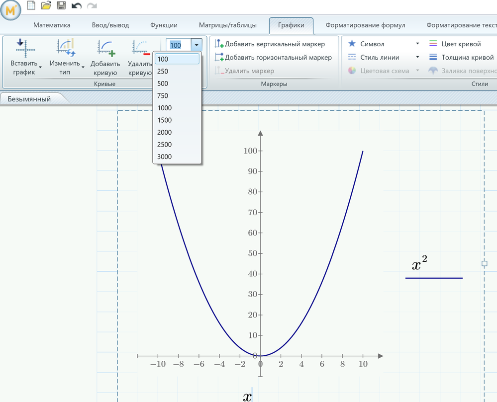

Numbers of points in Prime 4
Hi Valery!
Your image is, again, far too big, IMHO!!
Images that big clutter the threads and make them much harder to read and unclear. Images much smaller would be much better, streamlining the thread and better to navigate.
You probably use a 4K display like me and thats the reason for the big pictures,
If you don't want to go through the hassle of post processing the screenshots to shrink them, you could at least make them smaller when you insert them here - just resize them  with the mouse after you have inserted them with the "Photos" button and before you press "Post". Its quick and easy - it just has to be done.
What your picture shows is just a number of presets for quickplots and does not apply when you provide your own range variable or plot one vector over another.
As i have already written, the limit in Prime 4 is 2 million points for the whole plot.
Limits in older Prime versions were much smaller,  sometimes even smaller than the half million points allowed in a Mathcad 15 plot.

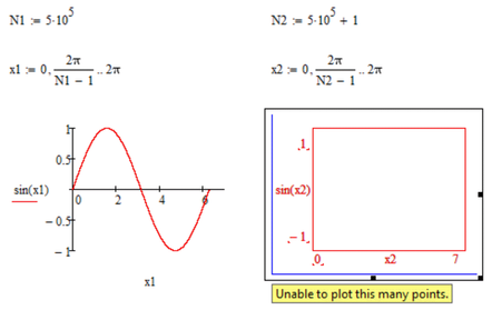

Here is a picture showing this.
Maximum points is 420141 and there is Mathcad 15
(To:richardm55)
Can't be checked by just looking at your pictures.
As I already wrote and showed the limit in MC15 is definitely exactly 500000 points.
This limit applies to the whole plot  window and you are probably trying to plot two curves consisting of 420141 points each making for a total of 840282 points which sure exceeds this limit.
