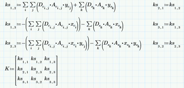

I'm finishing my master thesis and to get the results I have to make a new version of my advisor's old work, but I'm getting a lot of erros, someone can help me to fix? in annex are two files, one in word and one in mcdx.

Your error is in naming the calculation of matrix K elements as k.  This overwrites the value of k defined earlier as 0..3.
I simply renamed the elements of K as ks not k
Capture.PNG.

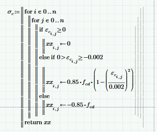

My advisor don't have the original one anymore, actually i'm having problems at this point:
I'm getting a 1x1 matrix instead of vector of values based on the elseif formula.
Any hint?

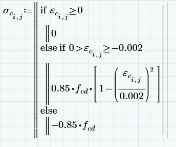

You have a square bracket in your calculation - which mathcad only sees as a matrix.  Replace with parathesis. That gets you a 1x100 matrix result.  Also you have a zero you don't want in front of the programming bar.
Not sure what result you really want.  I suspect you're after a 2D matrix.  I'd have written something like this.

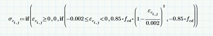

Assuming you have ranges defined for i and j, try this; it works in any version an edition of Prime:
