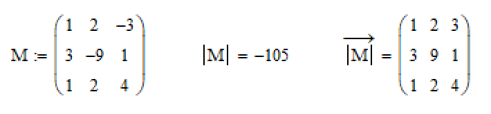

The typical case of the vectorize operator
