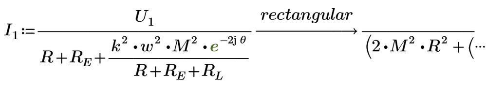

MW_10727886_0-1690342850423.pngHello, I am solving a circuit equation in Mathcad 9.0. I want to express the above equation as cos and sin identities (Basically expanding Euler) .I want the equation to look like U/I form .

The imaginary part is zero because Prime assumes all unknowns to be real and you did not provide any non-real quantity.
Guess you should have written
or
instead of
Using the modifier "rectangular" may also be helpful
BTW, "rewrite, sincos" isn't necessary anymore if you use "rectangular" or Re(...) and (Im(...)

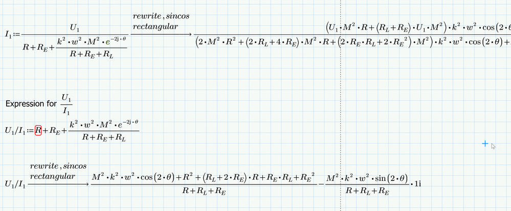

Anyway, with the proper substitutions your expression is:
Symbolically you can do:
One step further gives you:

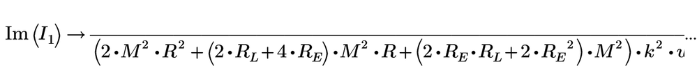

I am sorry for not attaching the sheet. It surely would have been easier for you guys to help us. I have attached the sheet, its stil not not giving me the Imaginary part.
image.pngimage.pngimage.pngimage.pngYou must write like this.
Thank you very much!

The symbol for the imaginary "unit" i (or j) is to be entered as 1i (or 1j). You put jθ as an argument to the exponent. That is in no way associated with the imaginary unit. That can be corrected by retyping the equation, or by substitution. The the rest follows:
