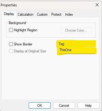

Every region in the worksheet has a property called "Tag".  You can set this for individual regions to the same value.
It is possible in vbscript to read the Tag property to see  which ones are tagged and respond accordingly.
Right click  on a region in Mathcad 15 and select Properties.
You get this dialog box to set the Tag.

ThisOne
ThisOne
