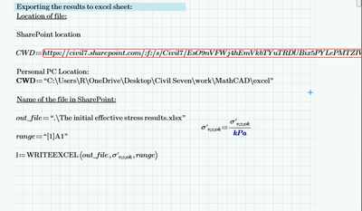

I have 2 questions:
1) Can I choose the location of the excel sheet in Sharepoint of our company ( using link) like I did below? I need the file in company data not personal PC.
2) How can I generate the same excel sheet for all the results instead of generating new sheets for each ?
The sheet is attached below , page no 4 , using Prime 9

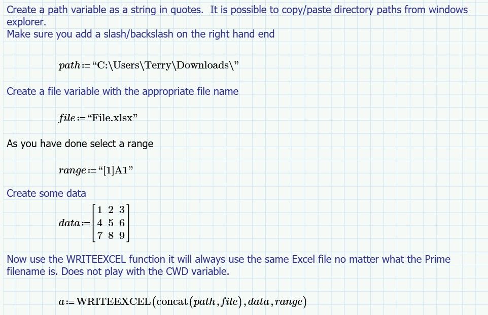

If the sharepoint directory is a string in quotations and a slash/backslash added at the right hand end the following could work.  I know it works on network drives.
If you name both the path and file as below Prime will always use this file name irrespective of Prime filename.
