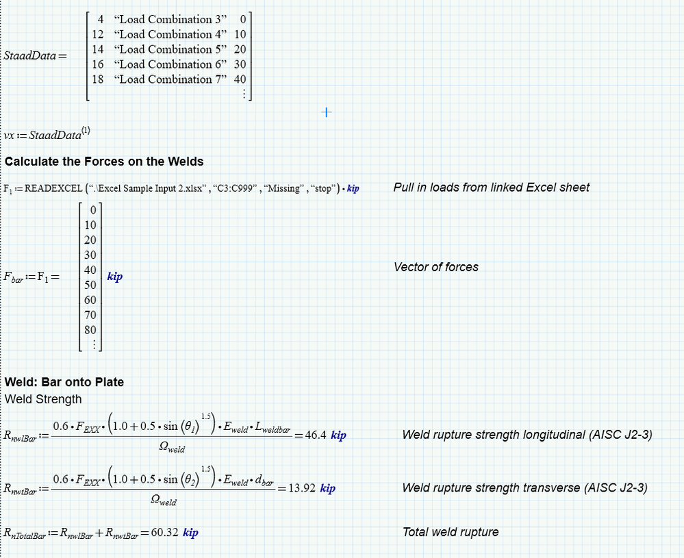

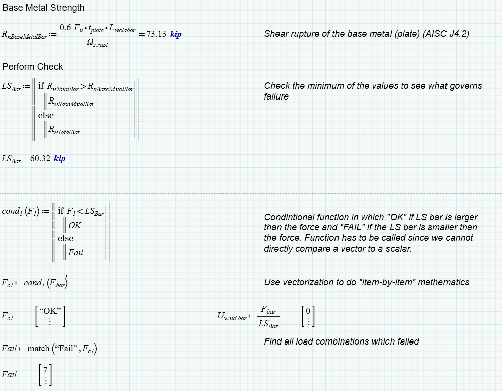

Hi, I have a series of loads from load combinations that are placed on my model. I export those forces into excel and then bring them into MathCAD as an array. Right now, I check by hand, what I think will be the limiting factors, run the calculations for those scenarios and then see what it returns. What I want to do is run all load combination calculations at once and have MathCAD tell me which load combination(s) are the limiting factor(s).
> I have an array with values and I want to extract the rows, from a different matrix, that correspond to the values of the array.
Still not clear for me what exactly this should mean.
Maybe you would be better off if you provide one or two specific numerical examples, each showing the matrix, the vector AND the result you would like to see.
Hi Werner,
Each force is associated with a Load Combination (string). I want to know which Load Combinations cause the system to fail. I attached snaps of my worksheet below.

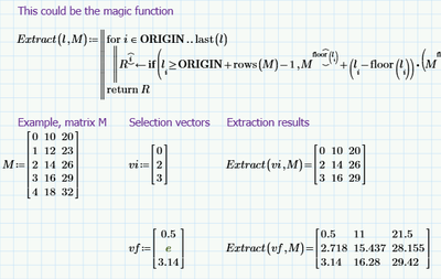

Decided to try some magic...

The function treats the values in the vector l as a list of row indexes. When an index is an integer number, it will fetch that row from the matrix M. If the index contains a fractional part, it will take the weighted average between two rows, as weighted by the fractional part.
So for 0.5 you get the average of (the values of) row 0 and row 1.

Thank you for the explanation! If I wanted to select a integer from this, how would I do that?Question1.PNGQuestion2.PNGQuestion3.PNG

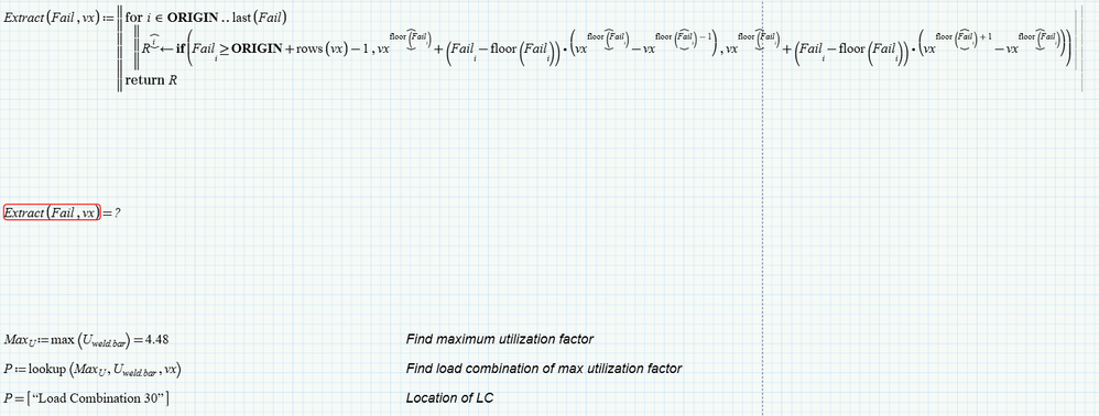

I am not sure what your function "Exctract" is supposed to do and unfortunately you don't show the error message which is thrown when you call "Exctract".
So just some remarks:
"match" returns indices and these always are integers. This means that your vector "Fail" consists of all integers and therefore "Fail.i" is always the very same as "floor(Fail.i)".
This means that "(Fail.i - floor(Fail.i))" simplifies to zero and your "if" condition has no effect as you always would get the row with number Fail.i of vector "vx".
I guess that the functions fails because of an index out of range?
I also don't understand the condition in your "if" statement:
if (Fail.i>=ORIGIN+rows(vx)-1, ....)
which, as I see it, is equivalent to
if (Fail.i = last(vx),...)
because no value in "Fail" can be larger than the last index of vector "vx".
Looks like you simply used Luc's function without understanding what it actually does.
Its still unclear to me what actually you want to achieve!
And, as Luc already said, don't post only pics but post the worksheet as well. If for some reason you are not allowed to post the sheet you may create a simplified stripped down dummy sheet with dummy data which shows the problem and state clearly what exactly you are looking for.
If you are looking for a vector of strings which only show which Load combinations failed, you may use
A shorter version is
