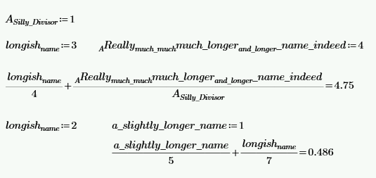

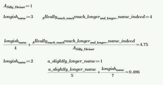

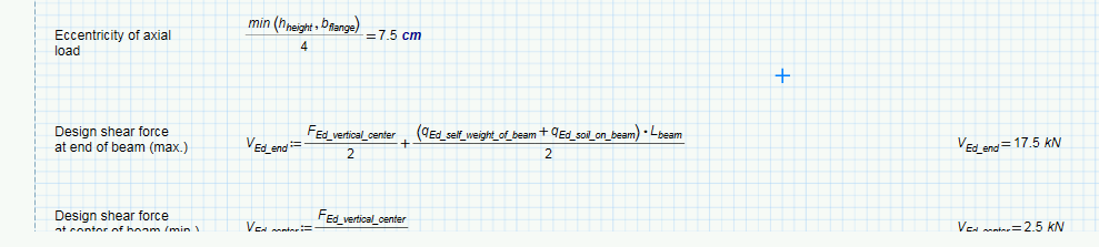

I'm converting Mathcad 15 sheets to Prime 7 and I noted that
some division lines are very faint (but not all). Picture as attached.
Is these some way to get a clear black division line to all formulas?
Thanks for advice!

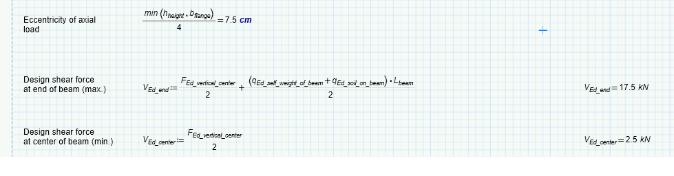

As attached is a part of the computation (same as was in the previous picture). I don't know it if has any effect to the visualization of the division line, but the formula is inside a collapsible area.
It works fine for me in Mathcad Prime 3.1 version. Can you test attached worksheet?
I opened the attached mathcad file, and the division line is grey, not black.

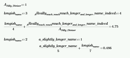

I've just typed the following straight into Mathcad Express 7.
Stuart

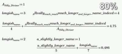

Here a few screenshots with different Prime zoom factors:

Display problems in Prime were reported here quite some time, mainly concerning division lines.
Usually the cause is that Prime isn't scaling correctly and the effect is differently depending on the zoom factor you set in Prime, the screen resolution and the Windows scale. So chances are that when you upload your Prime sheet, others don't experience any problems.
The suggested solution used to be to try slightly different zoom factors in Prime.
In your case its possible that a workaround might also consist in using variable names without an underline character in the subscript - just give it a try.

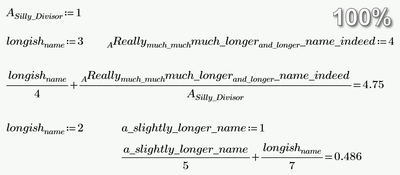

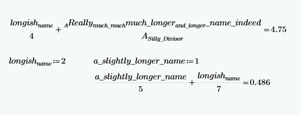

I normally use a laptop with a 1366x768 40 Hz screen.  I know, I know, that's why I use Mathcad at 80 % zoom, so I can actually see a little bit of a worksheet.   I'm hoping Santa Claus might decide I've been sufficiently good to get me a new (for values of "new") laptop with at least FHD or a replacement screen (sadly, my Dell Latitude only seems to go up to 1600x900 (HD+))
However, I digress.   When I change the zoom to 100 %, I get noticeably black division lines for the 2nd equation, albeit the 1st one still looks a little faint.
Shifting the equations down a few lines changes the line display yet again.   Now the 1st equation divide line is darker.

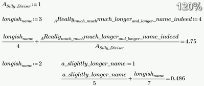

And if I vary the zoom, the lines change in appearance (or even disappear) up until Zoom = 180 %.
Here's 110 % ...
Stuart
