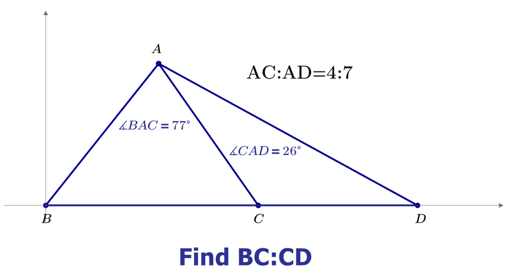

Find BC:CD
ttokoro
Find BC:CD
Find BC:CD
A memory from school days :-):
Since only the aspect ratio is sought, the choice of the line lengths denoted by the ratio 4/7 is irrelevant – this is a problem of so-called similarity geometry. In all situations similar to the given geometric structure, the same ratio results in the solution. Therefore, with the help of a calculator, paper, and pen, choose AC and AD in the assumed ratio ---> BC/CD = 1.333...
Perhaps there is a clever solution using reflection/symmetry that doesn't require any calculations. I'll have to puzzle it out.

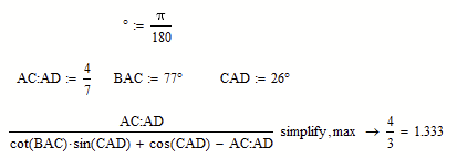

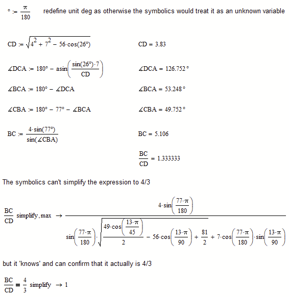

I can confirm your result, but unfortunately Mathcads symbolics is not able to simplify it to 4/3 which probably is the exact result.
And I am pretty sure that @ttokoro  will provide a very basic and clever geometric solution without much/any calculations 😉
Her my brute force attack in MC15

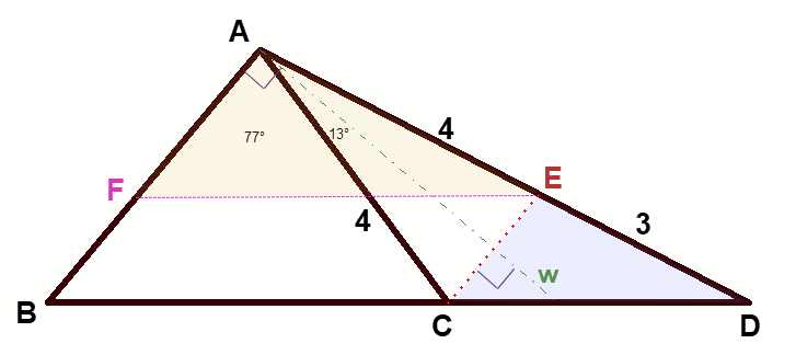

Let's consider the angle symmetry w of angle CAD.
Because 77° + 13° = 90°, it is at right angles to AB.
Now, if we reflect point C across w, we get point E on the line segment DA.
CE is therefore parallel to AB (both are perpendicular to w).
Now draw a parallel to BC through point E and intersect it with BA at point F.
If we choose AC=4 and AD=7, then AE=4 and ED=3.
The triangles CDE and FEA are similar triangles, so because FE=BC, we get the ratio
FE:CD = BC:CD=AE:ED=4:3

Ooops, OK, a much easier and more straightforward way is using the intercept theorem.
Lets construct point E as described above which intersects the line AD at the ratio 4:3.
Because AB and CE are parallel it follows immediately that BC:CD = 4:3

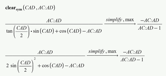

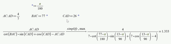

Looks like old Mathcad 15 with muPad is a bit more capable here
Prime 10.0.1.0:
Maybe  applying the special relationship between the two angles can help ...
Disappointment!
So lets manually apply some double/half angle rules
Heureka! Now even Prime is able to finish the job!
It even works symbolically without assigning values for CAD and AC:AD
So it seems that Prime's Symbolic doesn't know all that much, but it obviously at least knows the relationship
and therefore can simplify
Nonetheless its much simpler and straightforward in real Mathcad

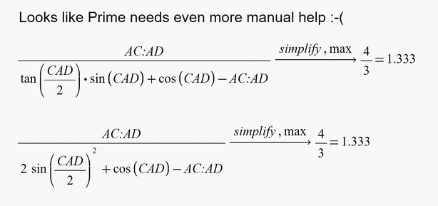

I still feel that its necessary for a complete solution to get the exact result 4/3 rather than the numeric 1,3333 one. Or in case of the generic solution its important to see that the result is a simple rational number (assuming that CD:AD is rational) and not an irrational value derived by sine functions.
Unfortunately Prime needed a lot of help to arrive at the exact result.

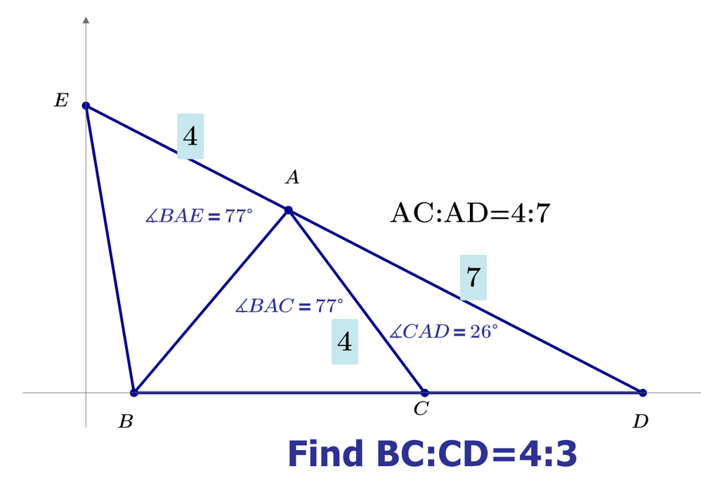

@ttokoro now posted here a picture where he used that 2*77°+26° = 180°. I noticed that, too (actually that lead me to the "half" relationship which I finally used) but could not find any use for it.
I also can't see the solution in the picture posted by @ttokoro .

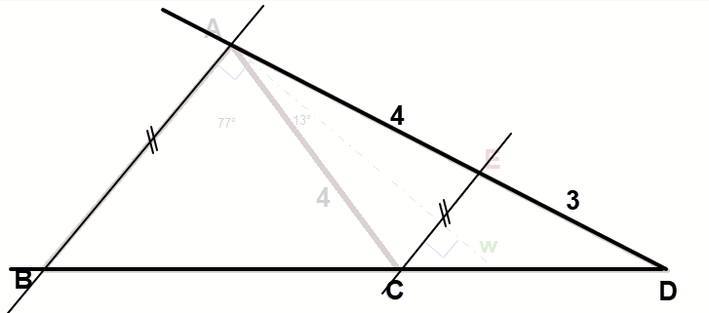

ttokoro
(To:ttokoro)
Thanks all how to solve this puzzle by Mathcad.
(To:ttokoro)
I see that D, A and E are collinear and that BC=BE. Basically ABC is mirrored at AB.
But I can't see the answer BC:CD=4:3 in your picture ....???
Of course, it's quite possible that I'm simply blind and can't see the wood for the trees.... 😞
ttokoro
(To:Werner_E)
D, A and E are collinear so the area of Triangle BED is divided by S(B,D,A):S(B,A,E)=7:4.
ABC is mirrored at AB to ABE. So, S(A,B,C) is also 4. Therefore, S(A,C,D) is 7-4=3.
B, C and D are collinear so the area of Triangle ABD is divided by S(A,B,C):S(A,C,D)=4:3. Therefore, BC:CD=4:3.
Using both area and line length rasio of triangle with same hight is the tips.
Tokoro.
(To:ttokoro)
Thanks, using the ratio of the areas additionally is a clever idea. Personally I'd prefer using the intercept theorem as shown above, but this may be a matter of personal taste.
