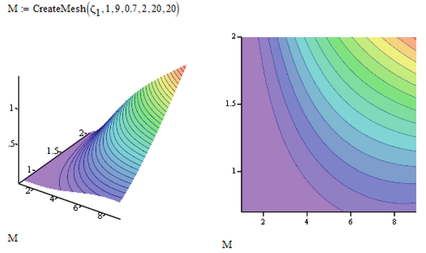

Playing with some alpha & p parameters. Would there be a way of plotting a surface plot (x,y,z)=(alpha,p,zeta2)?
Sure! zeta.1 and zeta.2 already are functions of the two arguments, so you may 3D-pot them directly, but I'd rather suggest using CreateMesh for better control about the ranges of input variables.
Unfortunately the calculation is quite sensitive to the ranges of alpha and p. As soon as the calculation fails for just one combination of alpha and p, the whole plot fails.
zeta.1 may fail because of the interval I had chosen (10^-8 to 2). function values at the start and at the end of that interval must have opposite sign.
zeta.2 may fail because of the guess value not being optimal for the chosen arguments.
You have to experiment a bit.
thanks. Yes I have noticed the sensitivity hence me playing with the data. I think I have have almost a range of realistic value as I added another block to my problem and it seems to work
