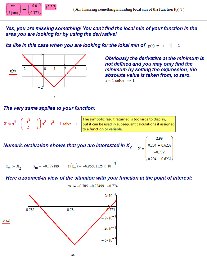

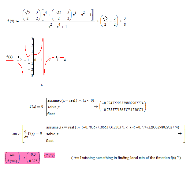

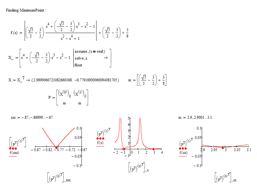

  Hello Everyone.
  From :
  Am I missing something in finding the local min of the function f(x), the above ?
  Thanks in advance.

LucMeekes
(To:lvl107)
I'll spare you a picture of the symbolic solution (4 pages high, 16 pages wide), but this is what Mathcad 11 (with Maple) makes of it:

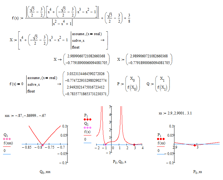

   Many thanks, Werner. Smiley HappySmiley Happy  The hint is very helpful to me. I guess the hint works well with the similar function :
           Regards.
(To:lvl107)
Obviously, as your screenshot proves.

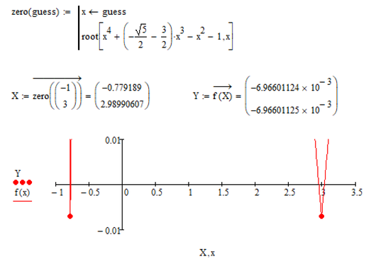

(To:lvl107)

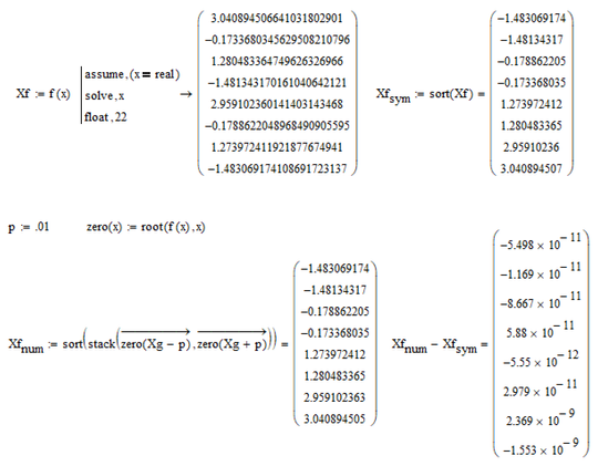

There is no need to use the symbolics (which will give you just numeric results anyway). You may consider using a solve block or the root command with appropriate guesses to get the two critical points:

(To:lvl107)
Looks like the results of your numeric workaround are accurate enough

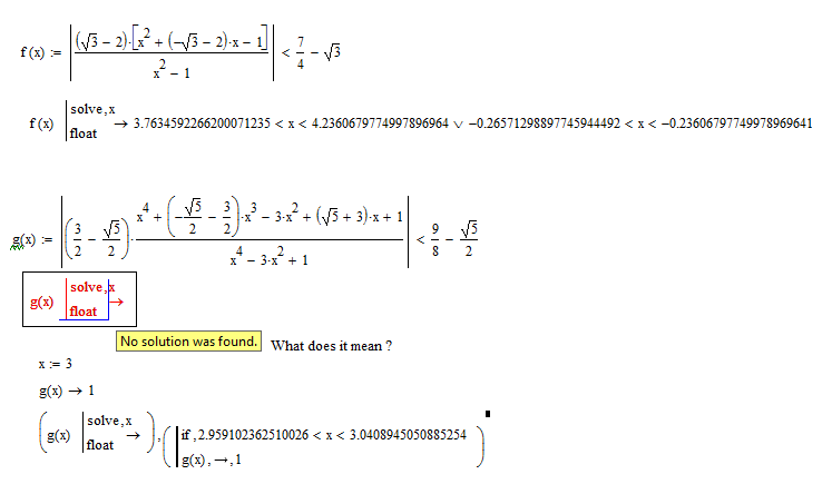

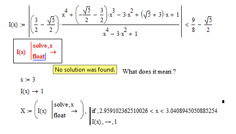

     "No solution was found". What does it mean in this case ?
Fred_Kohlhepp
23-Emerald I
(To:lvl107)
It may not be able to deal with the inequality.  Will it solve for equal?

But :
                Regards.

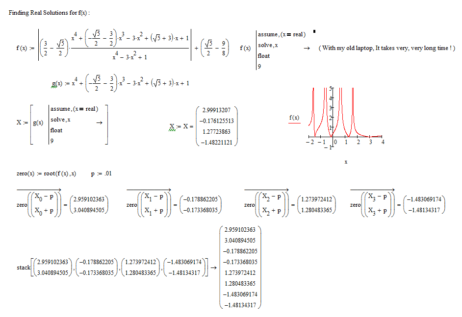

lvl107
20-Turquoise
(To:lvl107)
(To:lvl107)
There are equations of higher order which Mathcad can reduce and solve via symbolics and there are quite more equations (or inequality) which Mathcads symbolics can't solve.
Have you tried if Wolfram Alpha can solve your original inequality?
(To:lvl107)
It means what it says 😉
Mathcads symbolic simply is not capable enough to find a solution to this inequality.
EDIT: In your example which works OK Mathcad has only to deal with quadratic equations -> no problem

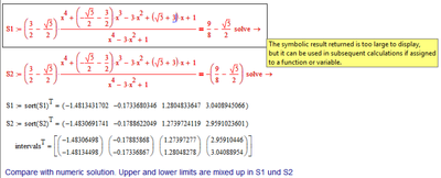

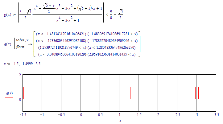

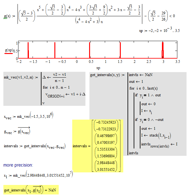

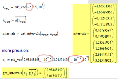

(To:lvl107)
Maybe it would be a good idea if you tell us why you need those calculations. There may be other ways to achieve the real task you are looking for.
Concerning the intervals where the absolute value is lower than the RHS you may let Mathcad solve the equations
LHS=RHS ->
and
LHS=-RHS ->
and take the appropriate values which form your two intervals.
(To:lvl107)

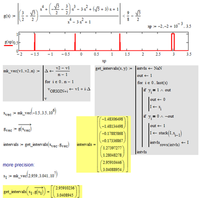

Here is a way to find the four solution intervals "by hand".
The first method uses a plot to spot the area(s) of interest and then created a large vector and picks up the appropriate values from there. You may refine the precision by narrowing down the range of interest (as shown in one example).
The second method shows a way to use symbolic calculation and was already described in my answer above.

 This reply is to say thanks again, Werner. Smiley HappySmiley Happy  . The following, it seems there no more precision. ( I just self-check my understanding about this )
   Best Regards.

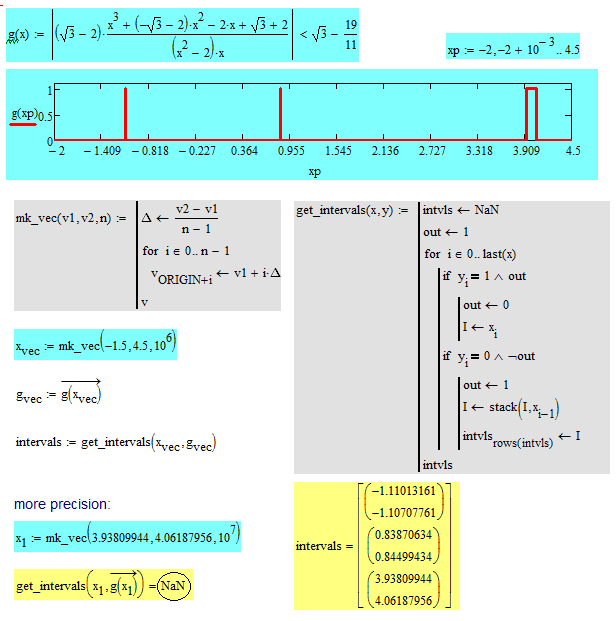

lvl107
20-Turquoise
(To:Werner_E)
Logical plot have 5 solutions
Intervals have only 4 solutions. ( It seems missing one )
Regards.
(To:lvl107)
Regards.
Use:  x.vec:=mk_vec(-2, 3.5, 10^6)
LucMeekes
(To:Werner_E)
"Mathcads symbolic simply is not capable enough to find a solution to this inequality."
There's Mathcad and Mathcad:
(To:LucMeekes)
There's MuPad and then there was Maple.
Nice to see (and not too surprising) that Maple in your Mathcad 11 can do the job as expected.
Unfortunately nowadays we can't buy a Mathcad version with Maple as symbolic engine nor could we license a valid older copy of Mathcad 11 for a new computer 😞
