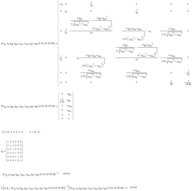

It is possible to somehow find the inverse of a() (a()^-1) and E*((s*I6-a())^-1)*b()+f symbolically?
(Mathcad 15 file)
Thanks.

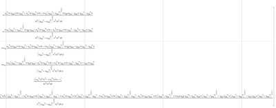

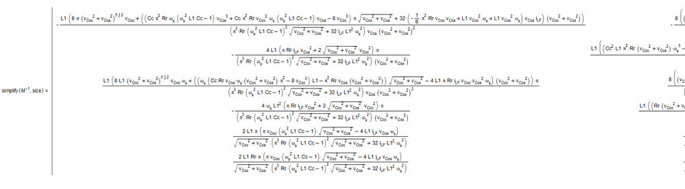

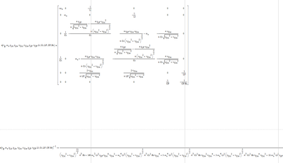

Calculating the inverse of that matrix a is a piece of cake for Mathcad 11.
The result is about 50 pages wide.
Below is a picture of the first 24.5 pages:
(unfortunately my screen isn't wide enough to show the entire expression, the zoom is limited down to 10 %, so I can't zoom out any further)
This is the first 3 pages:
This the last 3:
For your convenience, I've copied the symbolic result of the inverse to a new expression, so you can have a look at it in Mathcad 15, in detail.
Needless to say, the result of your final equation was also found, without problems.
It takes up a lot more space than the inverse of a. I've copied the symbolic result to function sol. You can have a look at that as well.

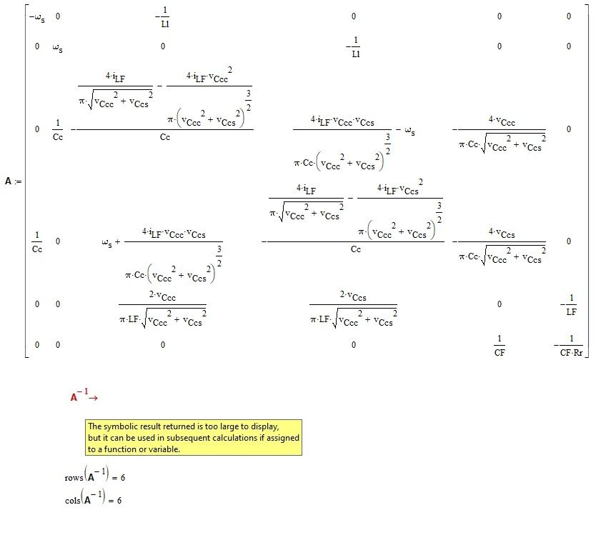

If the matrix is square, and not singular, then a symbolic inverse is possible. But I doubt if:
1. mathcad 15 can show it.
2. you will like the answer.
save the file as mathcad11 (.MCD) file and attach that. I'll see what I can do.
"If the matrix is square, and not singular, then a symbolic inverse is possible" - Yes, I know this, that is, if the matrix is square and not singular then the inverse matrix of that matrix exists and can be calculated (because the determinant of that matrix is different from 0):))
1. "Mathcad 15 can show it." - this is the point, Mathcad 15 cannot show the inverse matrix of a() (a^-1) and e*((s*I6-a)^-1)*b+f.
2. "you will like the answer" - In principle, I am interested in being able to perform this symbolic calculation (if possible, ie if there is any other way to symbolically calculate the respective inversion in e*(s*I6-a())^-1)*b+ f), as later from the previous equation results in some transfer functions that I am interested in seeing symbolically.
I have attached the Mathcad 11 version file.
