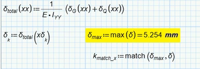

Good Morning,
I am trying to determine the exact x-location where the maximum deflection occurs. So far I have got a match function:
I wish to return the index k for which the displacement is maximum, the deflections have been calculated and stored in the vector delta-k. With the index found I can then determine the corresponding location where it is a maximum.
I know there are various topics available on this however I have not been able to get it working so far.
Callum

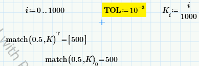

Callum,
In the Calculation tab, in the Worksheet Settings pane, change TOL to 10^-7
Or multiply your max value and entire delta vector by 10^4
The calculation was working with only one decimal place. When the default unit is meters, 1 mm is within the tolerance of 10^-3 (default setting), and it apparently ignores all of those significant figures.
You will also have to use the 0th index of the match to use it later on when referring to it in vector delta.
This solves the problem!

If you look at d, there are multiple locations with the max value:
the match function (read the help) returns a vector of the indices that match the requirement within TOL.  If you take a subscript of the match function you will get a single numerical answer, but it may not be the best answer:
note the change in TOL:

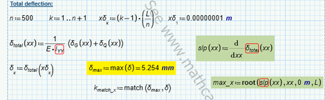

Sorting thru a vector may not be the best way to find a max value or its location.  Since you already have a function defined, why not find where it's slope is zero?  (Red circles are Express not recognizing previous answers on recalculation.)

See the attached file.  The first derivative of a function is the slope.  When the slope is zero you're either at a maximum or a minimum.

So my suggestion using the index on match or using the lookup function did not work OK?
Its hard to debug a picture as I not even see what the error message is telling you.

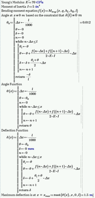

Several ways to find the x value where f(x) is maximum:
1. When using a solve block
Sometimes I use a solve block to go from my moment equation to my deflection equation, and then it's a function rather than a vector of values.
Then you can use the root function to find the maxima

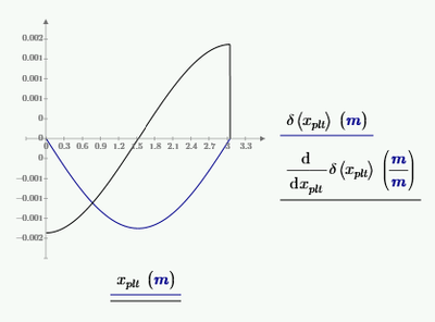

Root of the derivative works because maxima always occur where the derivative of the function is zero.
Plot them to be sure you got the right one:
2. built-in solver
Another way of finding maxima is to use the solver. Here is an example:
3. When using vector
However, you are trying to use a vector of values rather than functions. Here is how I solved the trapezoidal loading on a simply supported beam. Because trapezoidal loading is a piecemeal function, the regular integral doesn't really work. I had to use the definition of an integral to integrate discretely. The programs below use 1000 steps to integrate the moment function into the angle function and then the angle function into the deflection function.
You might find this method useful for your application.

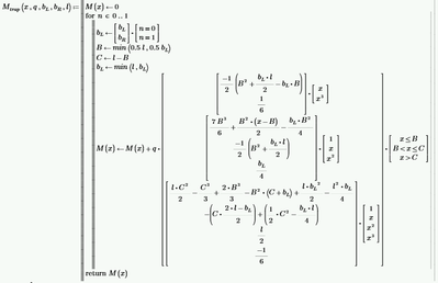

For reference, here is the formula for trapezoidal loading on a beam. This is for a beam that can have different tributary widths on the left and right. It took me a long time to derive this.
