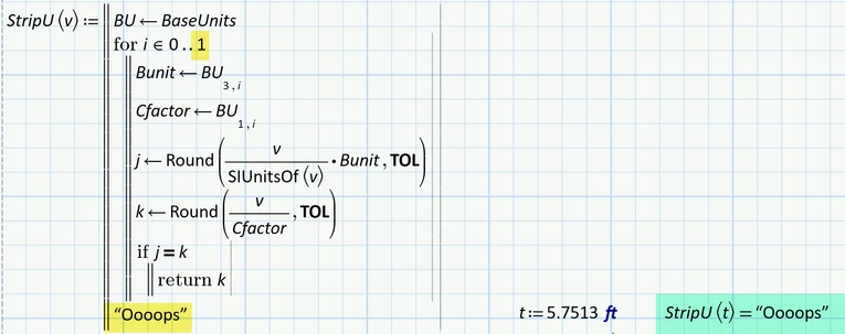

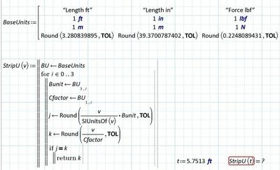

I'm trying to see if create a simple routine that will automatically strip the units from a variable and display only the numeric portion...so I can turn it into a string and use it in text functions. Essentially what I have right now...
The routine divides out the SIUnitsOf(variable) and multiplies that by a conversion factor that it sequentially looks up in a matrix.
And it divides the variable by the conversion factor's base unit (from the same matrix).
When I type out the procedure for an individual case, it gives the expected answer.
When I try to put that procedure into a "for" loop, it gives me an unexpected "These units are not compatible" error.
...can anyone see what am I doing wrong?

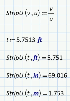

Easiest way is to simply divide the quantity by the desired unit, but of course you can make a function out of it:

1) better don't use manually typed in constants but rather expressions like m/ft
2) The error stems from the "Round" functions. Both arguments of this functions must be of the same dimension. When in your loop i=2, then the first argument c/Cfactor in the second Round command has the unit s^2/lb, but the second argument TOL is dimensionless. Hence the error
3) Even without that error your function does not work as you may expect
This means that the condition j=k never is true!
The reason seem to be round-off error which occur by the internal unit conversion:
Without the numerical round off errors (probably by choosing a lower value for TOL) the condition j=k would be true in any case (as long as the dimension is length). So you could not find out if the variable initially was defined in inches or feet - the first column in your table (feet) what always 'win'.
Generally said - once you assign a variable a value with a unit, there is no way that you can later determine which unit the variable was defined in as its stored already in base unit.
