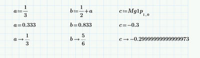

I saw other solutions but they are not helpful   in my situation.
Anyone have  idea how to convert  my  result?
I need -0.29999999999973  show in fractional form.
I checked settings, other forums but didnt find any solution.
It works really strange, I have latest version of Mathcad  Prime 6.0

1. You should attach your worksheet, not just a picture.
2. What fractional form do you need. What are you're looking for?
Note that if you want(ed) the symbolic processor to present c as 3/10, you have bad luck. The symbolic processor works exact.
Something that may help tremendously is if you omit the immediate evaluation of your definitions:
So get rid of the "="-es that lead to 0.6, 0.3, 0.1, [0,0.6] and [0.6, 0.9]  respectively.

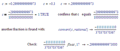

In case you're wondering:

Appreciate, now i understand how it works
