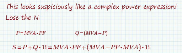

Can someone please explain how the right side (RHS) of the equation below represents active power (P)?
 Explain P: = PFUL*MVA + (MVA - PFUL*MVA) *i/N
given N = 2000, and
I run from zero to N.
ppal

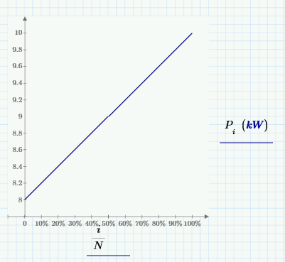

Pick representative values for PFUL and MVA:
But this doesn't make sense,  See file attached.

I'm not sure what you're looking for.  You typed an expression that would generate a vector in Mathcad (i/N where i is a range variable creates a vector) and I showed you how to plot it.  Your dialog with LucMeekes indicates you're looking into active and reactive power in AC circuits.

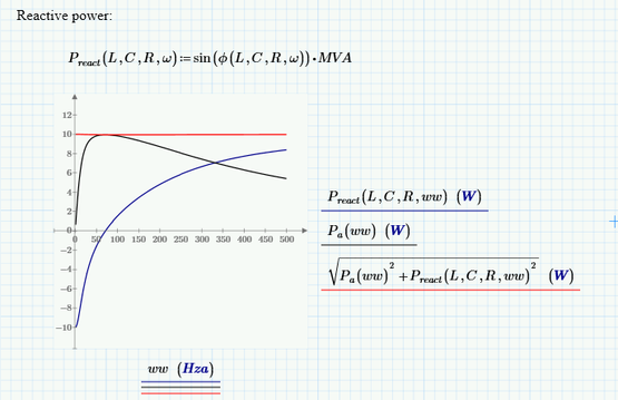

Power Factor depends on circuit parameters and frequency of the AC power.  Attached is a short discussion of power factors, phase angles and AC circuit components.  I'm not sure it addresses what you're looking for, but it may shed some light, and it was fun to build!  Prime 4 Express.

This is because as far as I can remember, P = S*PF, and (MVA – MVA*PF) is (MVA – P)*(i/N).
I cannot readily see how the term (MVA – P)*(i/N) adds to MVA* PF to give active/real power in the light of the expression S = P + jQ ,

But that's not true:

Yes, but:
and, suppose it's meant to sum over all i, then:
(To:MD_10068523)
As you can see the helpers here are wildly guessing about the meaning of the formula.
One suggests "i" to be the index of sum (which is not shown in your post), another suggests it may be the imaginary unit.
So it sure would help if you provide a source for the formula as Liuc already demanded, so we could see how it really should look like and what the exact meaning of the used variables should be. Where does the formula stem from? Can you provide a link or the like?
