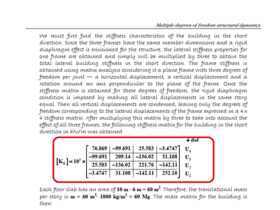

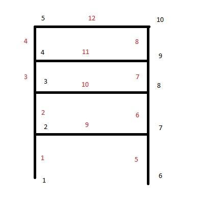

honestly, I want to calculate stiffness of example 4 to understand dynamic lesson in attachment below
can you calculate Global stiffness as example below?

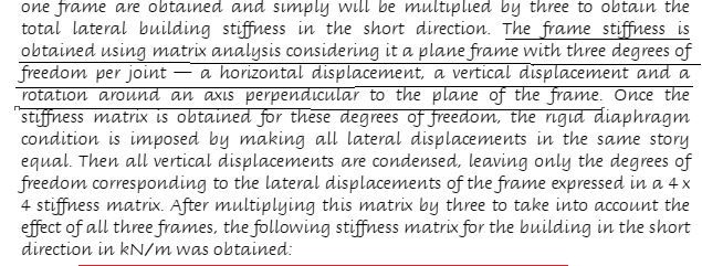

My mathcad sheet can calculate the global frame stiffness matrix for the plane frame as underlined below with the 3 degrees of freedom, horizontal, vertical, and rotation.
You would then need to make the adjustments to it as described in your example by assuming rigid diaphragm action of the floors and condensing vertical displacement.  The relevant mass matrix also needs to be assembled.  This is not done in my sheet.

I'm probably missing the point here, but is the attached along the lines of what you want?

The submitter has asked two questions the second being how to get the global stiffness of a frame with 10 nodes and 12 members then condense that to the simplified form in his second example.   My answer shows how to get this global stiffness matrix.

I have shown how to extract the horizontal deflections under horizontal force at each storey into a smaller matrix delta H.
I have shown how to use this sampled deflection matrix to get the required K.E
