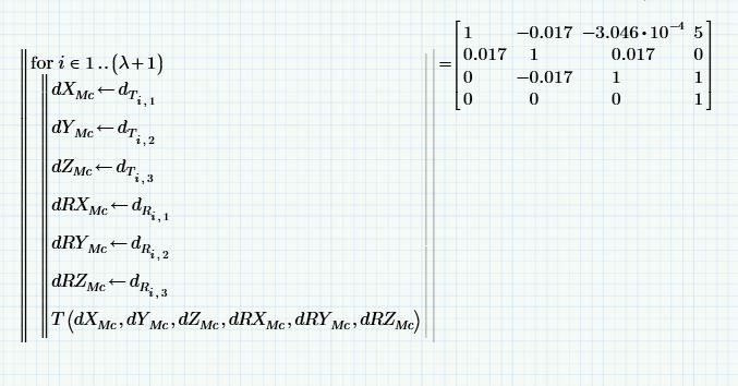

Hi
I want to use a hexapod (gough stewart platform)  in mechanical application.
The hexapode is formed with:
_ 1 base plate (ground)
_ 1 end effector (platform)
_ 6 leg (mechanical drive effector)
This system have 6 DoF for platform
For build this mechanical device, I need to calculate:
_ inverse kinematics : If i know the posture of platform, I find the leg lenght
  (the posture is : 3 positions : dX,dY,dZ and 3 rotations : dRX,dRY,dRZ)
_ Leg Forces (traction-compression only generated in leg)
For start, i build the geometrical model, for this, i define a ground mark : O with coordinates 0,0,0
1)
I define the hinge point of base : Ai
2)
I define the hinge point of platform : Bi
3)
I define the C point is the géometrical center of platform
Now the leg are AiBi vector
I define a user mark
The  user mark M ( 3 positions + 3 orientations) is define to mark O ( the origin of mark M is the point of interest)
For moving the platform, i define a new mark Mc from M
This mark is mark M augmented with strokes
And finally i calculate the AiBi vector, and i find the leg lenght.
I calculate AiBi at nominal position : not mouved platform
I calculate AiBi at mouved position
I find the stroke of effector (leg displacement)
Now I have a problem for Trajectory calculation
For know the stroke of effector, is necessary to compute leg lenght for trajectory.
The start point is define with stroke (in Mc)
dXmin  dRXmin
dYmin  dRYmin
dZmin dRZmin
The end point is
dXmax  dRXmax
dYmax  dRYmax
dZmax dRZmax
I use a lambda parameter for hash trajectory with 20 points for example
Now I find 20 group of position parameter.
I want to run my calculus for all position  group, and finally i make a graph with leg lenght for position parameter group.
My calculus is right for calculate leg lenght for one position of platforme in 3D space.
But i can’t calculate for trajectory ( group of parameter ) and i can’t make a graph
I’am a mechanical men, not a software programmer (lol)
Do you can to help me ?

Now for my problem
 But it's wrong, because it calculate only with  the last value of position parameter

XDN
(To:BA_8808696)
Hello
Yes , my calculation is right.
But, it is not applicable for simulation.
Because, for the stewart platform, i use the inverse kinematic model.
For simulation system, it is necessary use the direct kinematic model. Because, you need a coordinates plateform with length leg.
But for this calculation, we must resolve with Newton's algorithm. (because it's impossible to get a literal solution for this)
I don't make that, because i need only stewart platform for positionning system.
