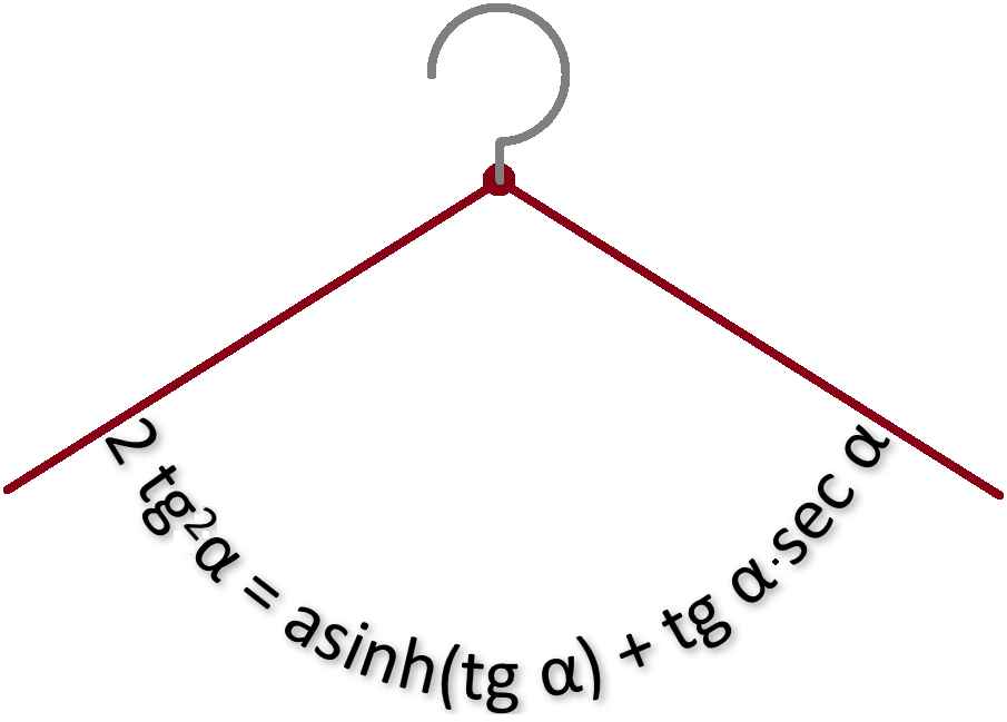

Has this equation one symbolic solution?
ValeryOchkov
Has red equation one symbolic solution?
See please the picture and the Mathcad 15 sheet in attach!

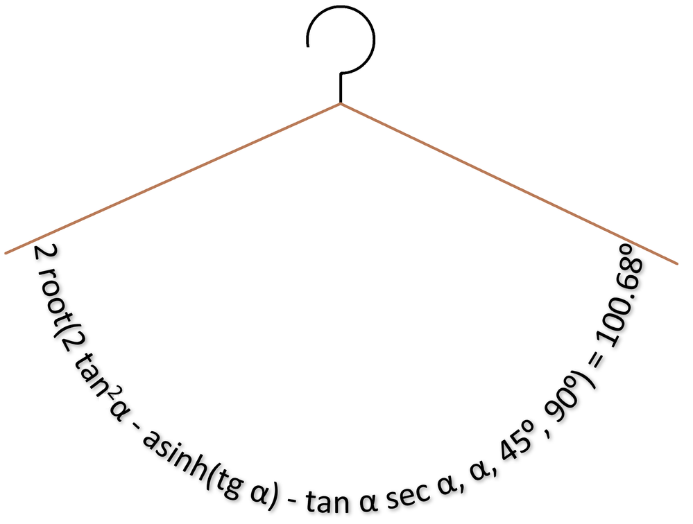

Sorry, more simple

Michael Kirsanov and Maple give us one simple symbolic solution atan(sqrt(5) - 1) with accuracy 1.3%
One more version of the visual solution
