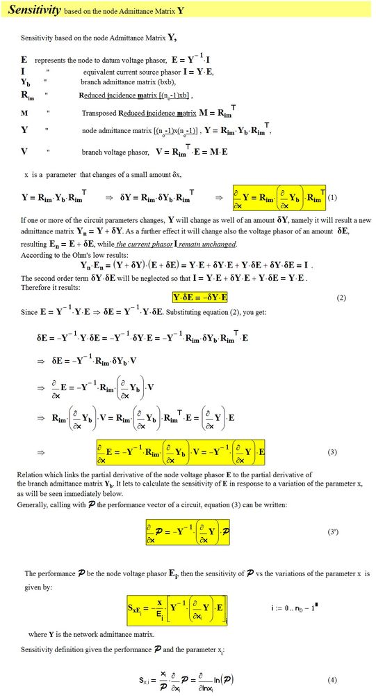

Can the analysis of the sensitivity of an electric network be useful? see photo and attachment.
