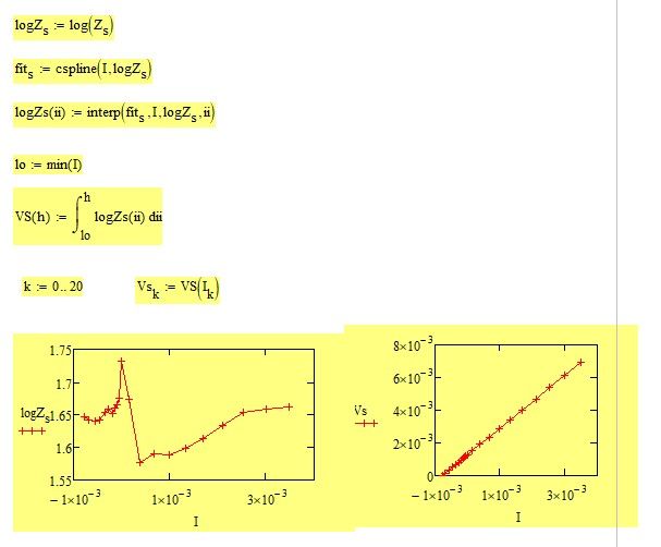

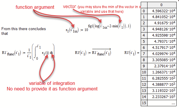

One possible way is to make the Integral function dependent on the index k

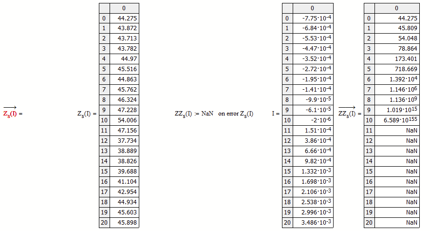

But your function Z.s returns far too high values for I > -2*10^-6 and so the integral will fail.
Note thats it a big difference if you call Z.s(I) vectorized or not vectorized.
I used "on error" to show where Z.s(I) fails:
Is this due to the bad fit of the data?
Z.s(I) looks almost like a constant number, not big variations. In more simpler calculations it is even taken as a constant as a formula for Ohms law V=R*I.
Do you want something more like this:
Alan
Yes, this I wanted. Except Io there must be 0.

Why?  If you aren't interested in values of I that are less than zero it would be best to remove them (and the corresponding values of Z) from the start.
Incidentally, in my solution I integrated logZs. If you actually want the integral of the values of Zs,  you will need to set  Zs = 10^(logZs) first.
Alan

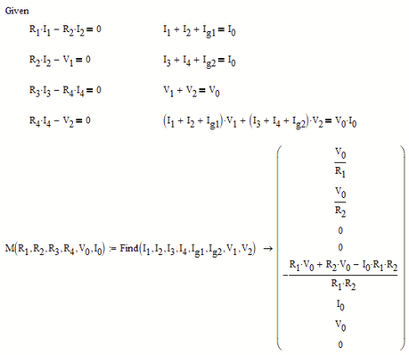

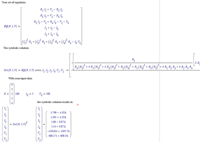

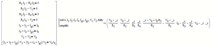

I am trying to solve an electrical network for its currents and voltages.
Does this system of equations have a solution?
Kristjan
Two unknowns were missing in mathcad file.

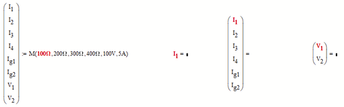

(To:ptc-1793698)
Don't use vector/matrix indices (like R[1) but instead the literal index (like R.1)
This helped.
What does the answer mean? Does it mean, that such a system does not have a solution, or something else?
(To:ptc-1793698)
@ptc-1793698 wrote:
This helped.
I am not sure what you mean!? I see a solution displayed! Do you see something different than I do? Why do you think that there might be no solution? Actually, as I will explain later, there is an infinite number of solutions because your equations are not independent.

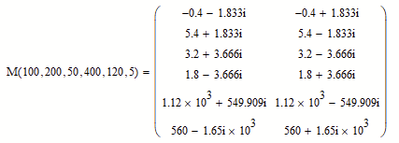

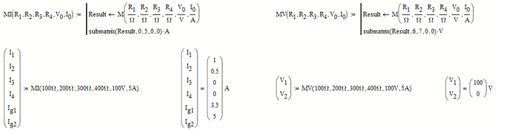

You can now use the function you created:
Unfortunately it won't work with units because the function M you created would return a vector with mixed units.
The error message is about that the first function argument must be unitless !?
Mathcad 15 won't allow to display quantities with different dimensions (here voltage and current/amperage) in one vector.
It would be allowed to assigning the result of the solve block "find" to a vector of different variables and then displaying the variables singly or grouped in vectors of equal dimensions. But that way you would have to define your input variables in front of the solve block and can't create a function dependent on them.
It would be easier if Mathcad would allow for a vector of functions, but it doesn't. So here's a not-so-satisfactory solution for handling units using your function M, using two auxiliary functions MI and MV:

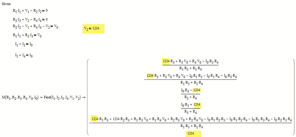

!! Are you aware that your eight equations are not independent - they are linear dependent and so you have one degree of freedom. You can chose one of the variables at will and then the others are dependent on it.
E.g. you could chose any value for V.2 - the symbolic evaluation of the Find command had chosen V.2=0 as you can see.
You can put all eight equation in a vector and solve it symbolically. You will get the same result was with the solve block (except the the result will be a row vector and not a column vector). But you can also add the "fully" modifier to see ALL possible solutions:
You see that V.2 = _z and _z can be any number. The other seven results are dependent on _z
Thank you!

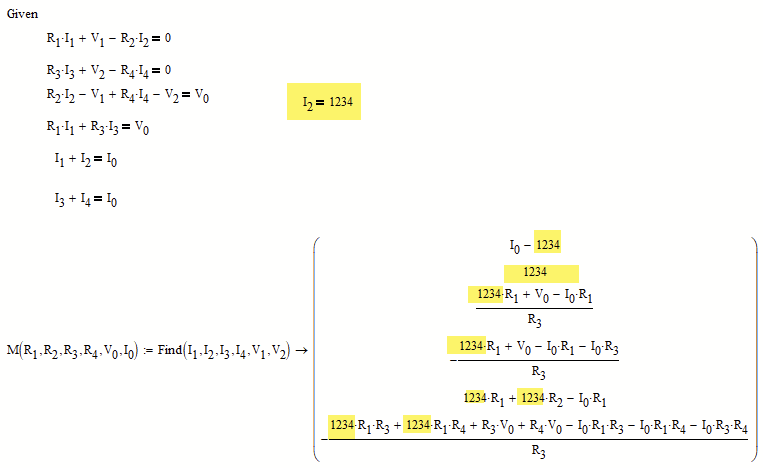

I now realized that something is wrong with the equations. The circuit has two nodes with no resistance in parallel with nodes with resistances. Hence a voltage drop in parallel with no drop in voltage.
This parallel node with no resistance came into my mind because of integration of values of resistivity elements gave as a result a bigger value of voltage than actually applied in the experiment. Hence I thought for a long time that there must be a current which does not pass resistor.
But it cant be so.
Another explanation for this finding is a built in voltage in parallel nodes . Here in attachment.
But again. One of the solutions is of zero value.
Can you tell is there a dependent equations among these six now?
unfortunately the six equations are dependent.
Adding the first two equations has the same result as subtracting the third from the fourth equation!

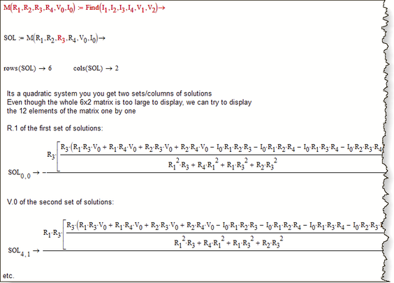

The symbolic solve is of no help here as the result is too large to display, but in the solve block you can chose one of the variables at will and you see that the other variables are dependent on it:
Maybe you'd like to post a picture of the circuit you are dealing with.
Or
(To:ptc-1793698)
Are you tying arbitrary equations?
Now we arrived at a quadratic system with two sets of solutions!
Numeric evaluations shows that at least with the chosen input values all results are non-real:

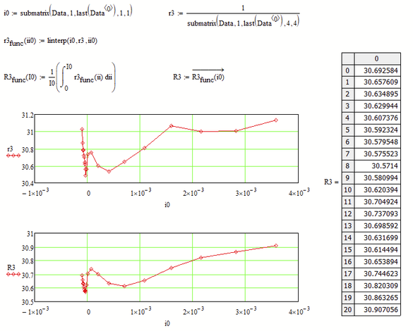

Here as a first attempt the calculation for R3. As the values of r3 seem to follow no specific function type I guessed that a simple linear interpolation would be as good as any other.
Not sure how to implement the rest - the calc loops for R1 and R2.
Yes, with R3 it is right that.
From that result it shows that at least for R3 these calculated values are quite close to values of r3 found from manual fitting.  The difference is probably less than 10%.
If such a situation is also for R1 and R2 these assumptions that calculations initially with r1 and r2 can give quite close answers for I1 and I2 may even hold.
But yes, this loop is something more difficult to do.
The next step would be now to calculate initial values for I1 and I2 using values of r1, r2 and R3 for R1, R2 and R3 in the Given block solution. I can try if I can do this.
