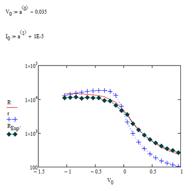

Somehow the results quite significantly differs depending on the fit used for r1 and r2 data.
Cant figure out this for today.
In principle these are the steps what have to be repeated in loops.
How to put these into such loops?
How can I see on the graph how did the fitting functions of linterp and cspline did fit the data as a function?
I found the way. Thank you.
This is what I do want if this was put in a recurrent loop.
cspline needs problably data collected more carefully.

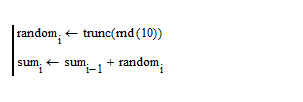

But I have no idea yet how to use these calculations, splines and integrations with For and While cycles.
Could you give me a simple worksheet sample of the For loop sample where (for example) ten random values are summed up?
As an output please give
1) single result as a sum of these ten random values,
2) vector result where intermediate summation results are represented (vector with 10 elements).
I am totally stuck now, do not know how to move on.

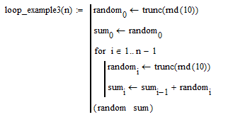

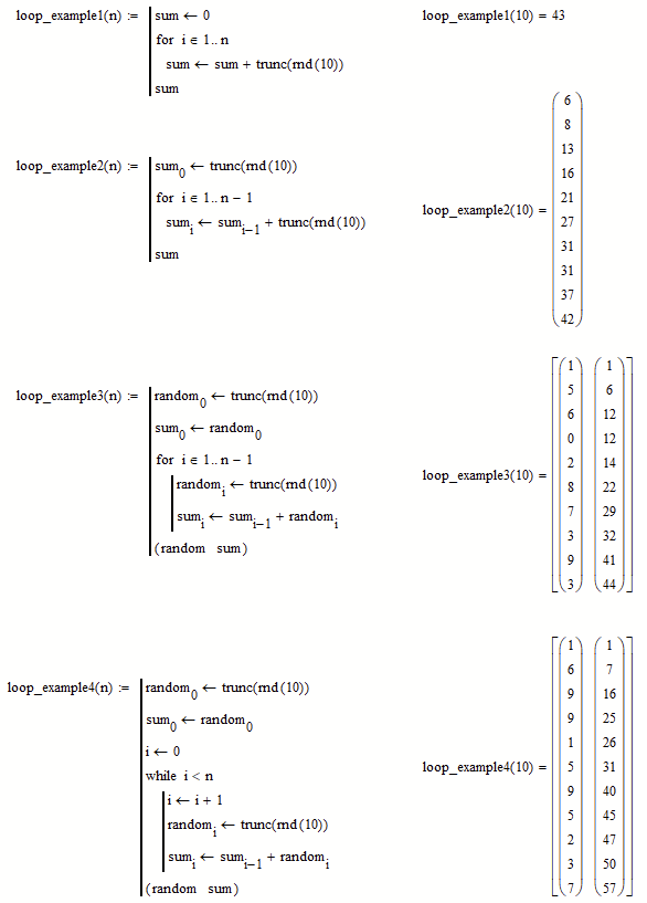

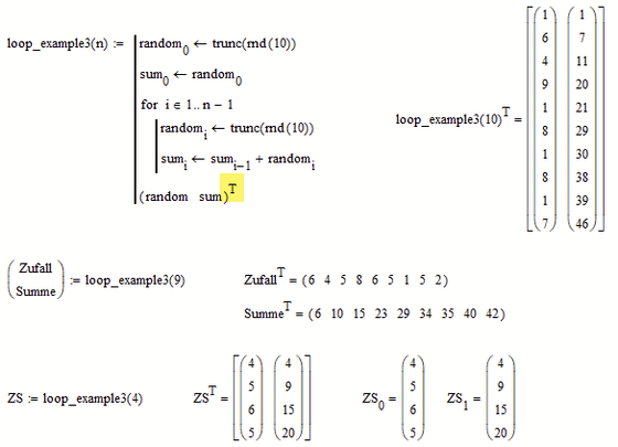

Not sure but I guess this is what you are asking for and I hope it helps:
MC15 worksheet attached
Question about example 3:
Here these results are in complex structure named loop_example3(10).
How to display the results random and sum as separate vectors (random) and (sum)?
The functions output is a 1x2 matrix whose elements are the vectors.
So you can assign the result to a 1x2 matrix of variables, like
[random  sum] := loop_example(10)
and then display the variables random and sum separately or use them for further calculations.
Or you assign the output to a single variable
Result : = loop_example(10)
which then is a 1x2 vector and display its elements one by one
Result[0,0 =.....                     Result[0,1 = ......
Here it might be better if the function is changed to return a 2 x 1 matrix (simply apply the transpose operator in the last program line), a vector, because now one index suffices to address the elements.

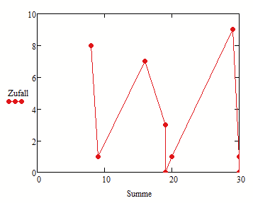

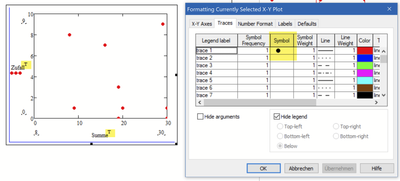

I see.

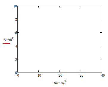

But why are these vectors not given as graphs? It allows to make a graph but the line is not visible in some reason.
When plotting you have to use column vectors, not rows vectors. like you did.
The function I used returns column vectors "Zufall" and "Summe" (German for "random" and "sum")  and I used the transpose operator when I displayed them just to save space by showing the values in a horizontal row rather than a column.
When you plot a row vector over another the points will be displayed but they will not be connected by lines. The points are very tiny dots hard to be seen unless you chose a "Symbol" and an appropriate "Symbol weight" in the formatting options of the plot.

You may use a global or a local subroutine to do the job.
This subroutine should add the created random number to the sum so far, therefore it has to know at least the last value in the sum vector but we may also provide the subroutine with the whole vector as argument.
The subroutine has to return the newly calculated sum and, because we also want to keep track of all random numbers used, the last created random number. So the routine may return a vector (or matrix) with those two scalars, but it may also return the full vectors of values.
Find attached a MC15 worksheet with a few different examples.

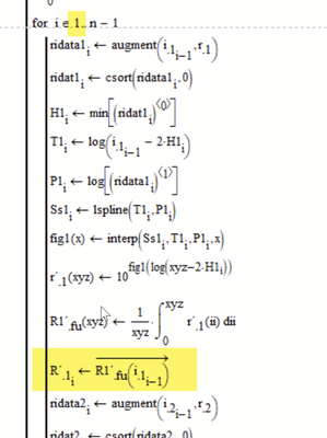

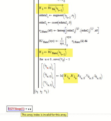

I tried to construct a loop for my calculations.
It gives me some errors, but I do not understand what is wrong.
Can you tell?

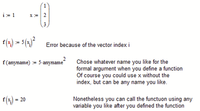

1) Move down the definition of r.1 etc. The error is because you define r.1 before r1r2R3 is defined.
2) Mathcad does not allow a vector of function to be created. You don't need it anyway - guess all thats needed is to remove the vector index when you define your interpolating functions. I think its no harm if they are redefined in each iteration step and have the same name.
3) When you defined r.2.func you used the formal argument "ii0" on the left, but "ii" on the right. Can be any name, but must be the same on both sides
4) When you defined R'.1 you forgot to type the dot after R'
5) when you define a function, the formal argument can't be a vector indexed variable. You can chose any name you like and call hat function with any other variable name if you like. So simply remove the vector index when you define your functions on both sides.
Example:
6) You define R1'.fu as a single variable but use it in the line below like a function when you define R'.1??
A further line below you again use the just defined variable R'.1 like a function?? Not sure if I corrected those error the way you intended it. Same problem with R2'.func.
7)  At the end of the program you use a matrix index "u" which nowhere is defined. No idea what you had in mind here. Should it be "i" instead??
In the attached sheet all errors with the exception of 7) should be corrected but maybe not the way you intended it.

The program indicates different errors if I click on a name of the program loop.
For example: This value has to be vector.
Possible this is because of this u that is useless in that instance.
If I take it out another error occurs:
This array index is invalid for this array.
and it indicates in
as if indice of i-1 is a wrong indication.
Obviously I do not understand the language that I should use.
When I open your sheet I see a different error than the one you describe:
So obviously the elements of matrix R'1 are not vectors and so you can't index them with index i.
To debug I inserted a return statement to see what R'1 looks like and as you can see it is a 2-element vector. The first element is the scalar 0 and the second is a 21x1 vector. I guess this is not as intended.
The reason is this:
So R'.1[0 is set to 0 by default and the elment with index 1 is the vector you assign.
Do you really need to keep all the vectors R'.1 for every iteration step? I don't think so but I can't be sure as I already lost track of your calculations and very demanding variable names long ago.
When I change the program so that R'.1 and R'.2 are overwritten en reused in every iteration step and change the call of function M accordingly, the next error pops up
I don't know what kind of data structure you have in mind for i.1, i.2 and V.1 !?
In every iteration step you call M 21 times and so each iteration step would produce 21 of those 3x1 vectors. Do you really intend to keep them all and is it this that your function should return?
BTW, the error you describe (index i-1) stems from the fact that your outer i-loop runs from 1 to n-1.
When you call your function with argument 1 this loop runs from 1 (down) to 0 and when i=0 the index i-1=-1 is invalid.
Why not let i run from i to n?
I guess/hope that the attached file may do what you intended.

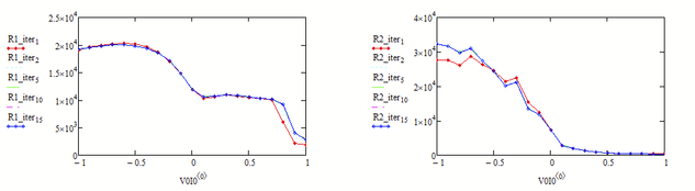

I did 15 iterations and it seems the the resistors don't change significantly.
Note that because there are no initial values for the resistors, R1_iter[0 is not a vector but simply zero.
Here is a slight variant of the program, getting rid of R1_vec and R2_vec
I will put r1 and r2 as initial values for R1_vec and R2_vec, as such they are in the calculation approach, r1 and r2 coming from the modeling of impedance spectra as differential values dV/dI, as R1 and R1 should be V/I.
This is now what I really wanted.

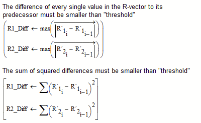

In the attached file I changed the for-loop for a while-loop which stops either at the maximum number of iterations or when the R1 and R2 values did not change more than a given threshold value in the last iteration step.
I could think of two possible ways for a measure of change
You may chose what you find most appropriate or use something else like the size of the difference vector.
When you are only interested in the last set of R1 and R2 values, you may also change the function so it will not keep all the intermediate steps but just the last two.

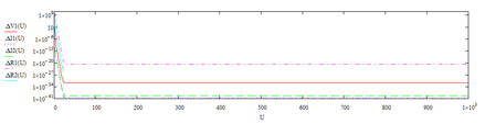

This condition is condition is very useful to have in calculation loop.

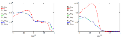

We studied a bit the situation with the conversion as the number of loops enhances and found out that there is a certain limit. And possibly this is connected to the quality of initial data from fitting of impedance spectra.
But also I found out that another question arises. The resistance calculated on R1,R2 and R3 should converge theoretically with that from device voltage  and current : V0/I0.
But they do not.
 If I insert a correction into the V0 and I0 something more overlapping appears, but not again.
To estimate this offset, if this is a cause of the missing overlap between two curves of R: calculated and experimental, a system of two equations must be solved in the course of the looping program and applied in the next cycle:
My colleague argued that this might be because of the device, but this still has to be found out.
Is it possible to incorporate this correction into the cycle?

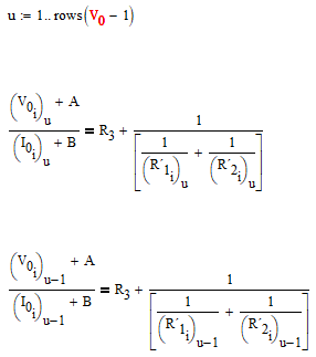

Hmm, but what you show are 42 equations (u runs from 1 to 21) in just two variables A and B. Its not possible to solve that kind of a system but you could use a solve block with "minerr" to find "best fit" values A and B in each iteration.
Or do you expect A and B to be vectors with 21 elements, so actually they should read A[u and B[u ?
The latter could be achieved via a solve block wih "find" which is turned into a function and called from within the program.
But what would you like to do with the scalars or vectors A and B?
This is not yet clear to me which is better.
If these variables are due to the off-set of the measurement device there are two possibilities. Either this off-set is a constant in terms of A (volts) and B (amperes) and applies to every measurement condition, or it may have a kind of function, for example a linear function.
My colleague argued that off-set may vary in different ranges of applied conditions, as a device switches between different electronic blocks if it leaves and enters different measurement ranges.
We didn't notice this before as something important. I was aware that there is such, but now it maybe turns out that it may interfere with these calculations.
I would like to see, what would that possible off-set look if it was calculated as a vector and with a find block.
If this turns out from this calculation that the values in that vector vary very little, the option with "minerr" to find a "best fit", would be enough.
