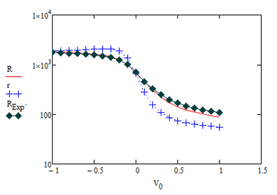

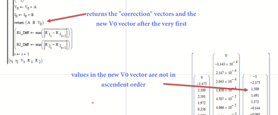

I implemented the second variant from the above but I may not got the point. Actually I lost track on your calculations already long ago and just concentrated on the help with Mathcad itself.
The "correction" vector A contains rather large values and as a result the elements in the new vector V.0 are not in ascending order after the first iteration. This makes "linterp" fail as it expects the abscissa values in ascending order.
Do you really intend to change the nicely spaced values in V.0?
Anyway - the attached sheet might give you an idea how to implement whatever you really had in mind. Good luck!

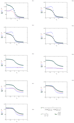

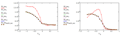

Hello!
I just found something that probably shows that this difference what I have been bothering about, is not about this corrections of A and B.
My colleague made a series of fittings with different results for the same type of network but with different numerical values.
These graphs of difference in resistances showed remarkable differences.
And here they are.
I feel a bit bad with my wants.
Thank you for helping me, again.
I feel that at the moment I am in a kind of confusion, and not having a good idea, what to do and what do these results mean.
Need to think and meditate a bit.

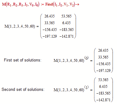

I would like now to solve the similar task for the next circuit which has one more unknown element.
What is wrong with the constants in the definition in the Given block?
And how to give the solutions now in the the same form as previously:
if there are two sets of solutions for the system of equations? How should this to be addressed here?
(To:ptc-1793698)
What about I3? You neither provide is as a function argument of function M, nor can you solve for it (because you only have four equations).
So either you have to provide the value of I3 in function M or, if you want to solve for I3, too, you have to supply a fifth equation and then solve for I3, too.
Here I added I3 as additional function argument and show how to select between the two sets of solutions vi the column selector

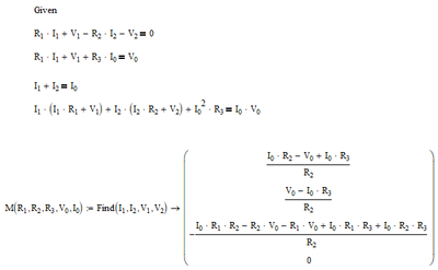

Thank you for noticing this I3 in the Given block.
I come to the computer to do these things at the evenings after a day job, and my brain is not in a good shape at this time of the day.
This was by mistake, this I3, it has to be there I0.

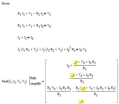

Also today, I noticed myself suddenly that the fourth equation in not right. It has to have additional members:
But this finding, as it turns out, is a dependent equation.
(To:ptc-1793698)
Yes, you need another equation.
The solution 0 for V.2 does not necessarily mean that the equations are dependent, but if you add "fully" and "simplify" you see that you can chose any value for V.2 (Mathcad calls it _z) and calculate the other variables depending on it.
