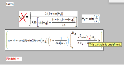

Hi all,
looking for some help to solve the following equation (circled in red) to find one of the limits of integration (b).
R.d is the other limit of integration which is fixed and known.
The angles 'alpha' and 'beta' are known and fixed.
w is known and fixed, q is known and fixed.
Angle 'theta' varies with r and b.
Any help would be appreciatred - currently trying to do it in mathcad 15 but i also have access to prime

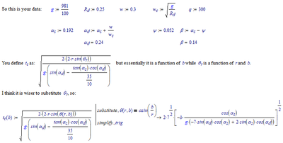

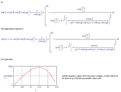

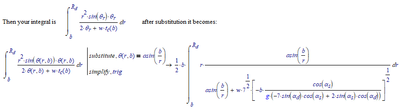

LucMeekes
(To:Pyros1111)
LucMeekes_0-1577968186414.pngLucMeekes_1-1577968213702.pngLucMeekes_2-1577968250454.pngLucMeekes_3-1577968275326.png
I think you should check the equations and the known values.

That makes it simple to solve numerically. Note that you probably will not find a symbolic solution.
