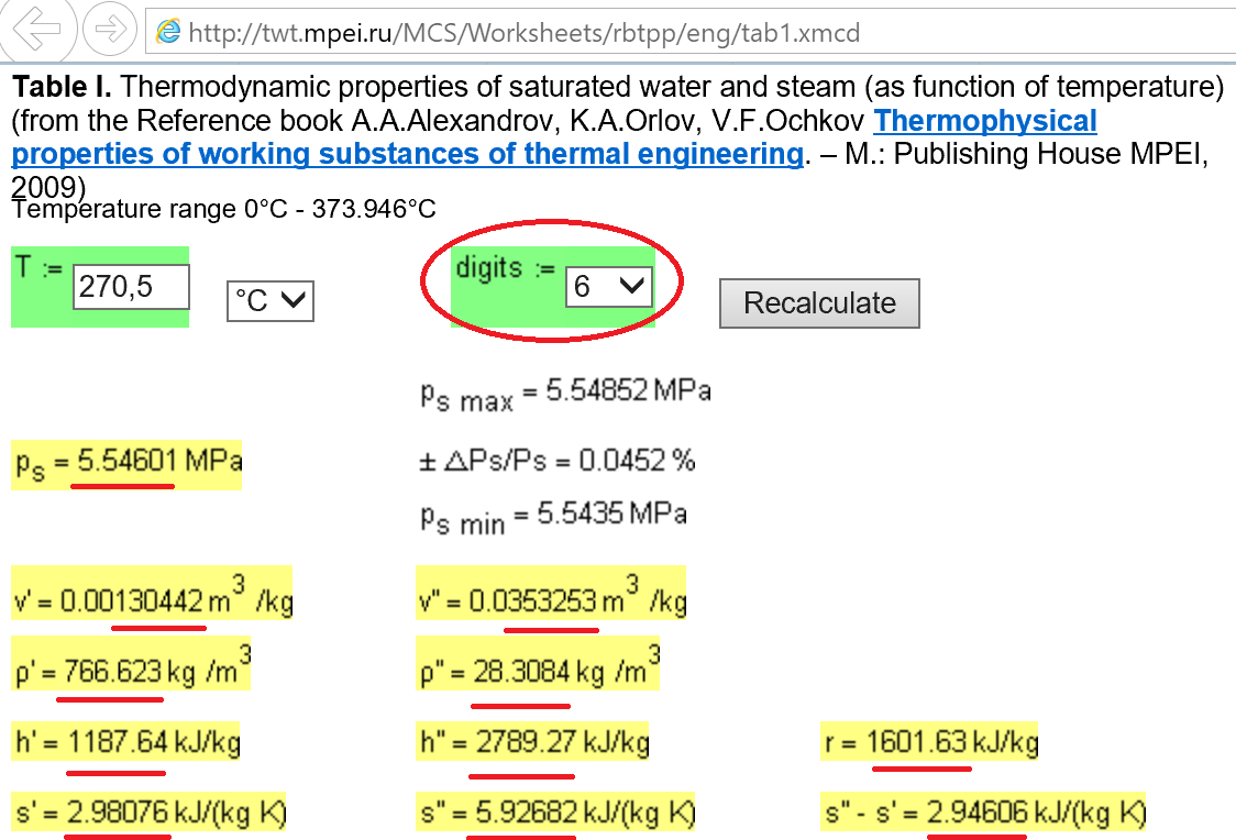

I ask 20 years MathSoft/PTC show not digits AFTER decimal point but COMMON numbers of digits in answer.
I use in Mathcad Calculation Server one function for this
See one example please
http://twt.mpei.ru/MCS/Worksheets/rbtpp/eng/tab1.xmcddigits.png

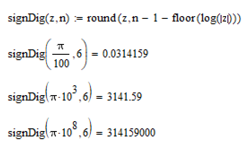

Here's a simply way to round a value to any number of significant digits rather than to a number of decimals. B1.png
