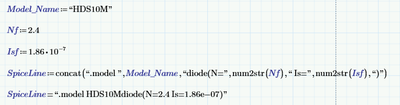

Prime will not let you do that in a  text block, but don't despair.
A text block is a nasty thing to copy text from, especially if it contains live math.
What Prime does offer is manipulation of strings. So you can build your SPICE line in an expression.
It might look like this:
The interesting part is that you can have Prime write such text strings to a file, so you could build your entire SPICE deck from within Prime.

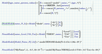

Assuming that you may be using multiple diode models, you can use a function to build the SPICE line:
And you can take it a step higher by defining a more general function Model, from which you can create DiodeModel and other models:

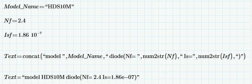

July 23, 2022
Like this:-
Cheers
Terry
July 25, 2022
Hi Terry,
  Great answer, I can make that work in combination with Luc's answer below.
