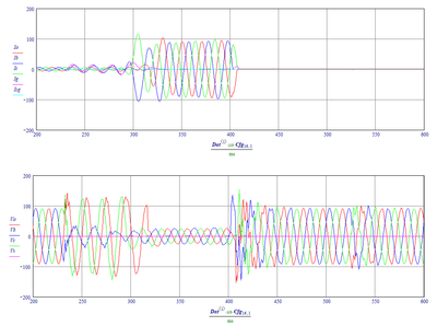

Does anyone know how I can read a binary comtrade data file.  In this case "File.dat"
What is comtrade? See https://en.wikipedia.org/wiki/Comtrade.
I am interested in displaying the File.dat The others are easy to open in mathcad.
Once I can view it then I can do further processing to it in mathcad
Thanks.

Any way. I got these results from your file set:
So there are 8 analog channels, 4 with current and 4 with voltage.
And the data is:
ILA is in column 2, ILB is in colum 3...ULA is in column 6 etc.
From your info I gather that you get ILA as 5506, 2816 etc. What makes you think that ILB should be other than 59.05, 143.829 etc. ?

Hmm, found one error. In the last statement of the ReadComtradeBinary function. You should correct as follows:
The 'multiplier' is added, instead of the 'adder', but that should not make (such) a big difference in ILB.
Now the analog data reads:

The reason I think it should be what I stated is that I have another software that is supposed to read the samples like we are doing here.
The software is SEL SYNCROWAVE and a trial version  can be downloaded here.
Essentially it takes the data from a protection relay and then  displays graphically. As you move the cursor you can see the reconstructed data samples. The A phase seems to reconstructs ok. The other phases seem off.

A former colleage of mine gave some good advice several years ago: There's always one more bug.
Found it. The for loop should read:
I had double ORIGIN. But worse: I had a too high offset, 2 instead of 1.
Anyway that's now corrected. The data now reads:
(There's your 39.286 for ILB ).

You have saved me hours of work! -
We had a fault on our 330kV interconnector and the relays have a bug and not giving a fault location. I can now use this data to do a fault location and send the helicopter out
Thank you so much.

I found the cause of the error message.
Your config file specifies no sampling rate(s), so it uses variable (event driven) sampling. The read routine for the binary data file isn't equipped for that. I didn't include support for that, probably because I didn't have an example file set that actually uses it. So far all work was done with files provided earlier in this thread.
I'll see what I can do to have it handle that situation as well, now that I have your examples to work with.
LucMeekes
(To:AG_9821619)
Hola Ana,
I guess this is what you are looking for:
From the data file, I deduce that you probably used a 1600 Hz external clock signal to trigger the sampling (the samples are 625 microseconds apart), so it's not actually variable.
If I made no mistake, the attached update should allow you to make similar pictures for the OSC001 file set using Prime. (I can only change the program, I cannot run it because I'm using the free Express edition of Prime, which doesn't allow programming and a few other things).
So go ahead and use it, and thoroughly check that the output is correct, as far as you can. Don't hesitate to get back here with any problems you may encounter using this utility.

Hi Luc, it's Ana from Argentina (I had a problem with my previous account).
I have great news: IT WORKS!
Your code has helped me so much!
Thank you so much for your time, I'm really greatful!
