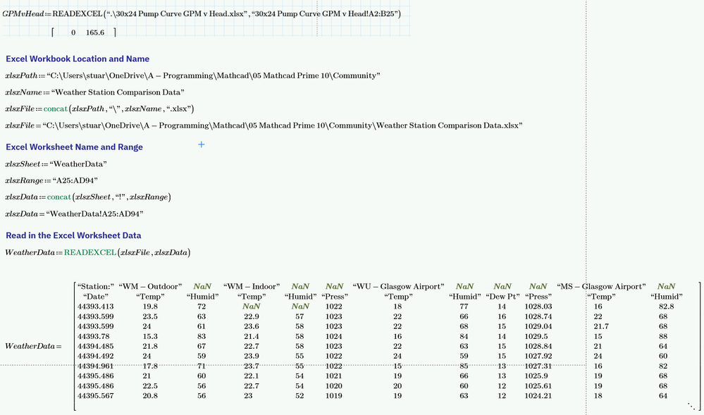

1 ) Apparently, there is no substitute for copying and pasting a block of Excel cells in Prime as we could do in MathCAD 15.
2 ) This has forced me to use READEXCEL but unless I shorten all of the file names and work sheet names (in the READEXCEL function), the line runs off the right side of the printable area. I tried inserting a line break (Ctrl+Shift) but that didn't do anything inside the READEXCEL function.
Is there a way to break up the READEXCEL function at the comma? I don't want to rename files as that will make documentation less meaningful. I shortened the path to ".\" but the line is still too long.
Have you tried defining each element of the workbook name and worksheet name as string variables and using concat to build the longer, complete terms?
For example:
You can break the path, etc names up into as many substrings as is convenient to read in your worksheet.
Stuart
For example:
Stuart
Thanks, that worked perfectly.

The page overhang of your READEXCEL command is not that large.
So you could help yourself either by predefining the path and filename in a variable and use that in the READEXCEL command and/or by choosing a smaller font size for this one command.
StuartBruff
