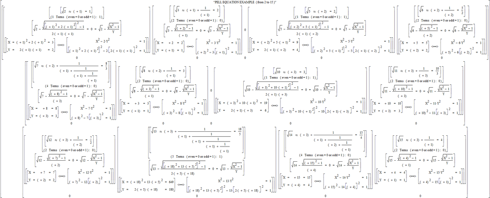

Hello Everyone again,
Now I need help with correcting the Pell_Test(N) function, the above. ("This array index is invalid for this array")
Thanks in advance for your time and help.
Best Regards.

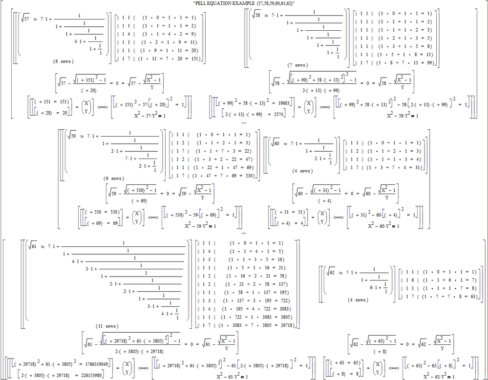

lvl107
20-Turquoise
(To:Werner_E)
I guess the Pell_Test(N) function need to adjust a little bit :
after adjusting a little bit :
And while I am learning about match( ) , submatrix( ) function, I adjust the function a little bit :
Thanks again.
Best Regards.
lvl107
20-Turquoise
(To:lvl107)
lvl107
20-Turquoise
(To:lvl107)
lvl107
20-Turquoise
(To:lvl107)
