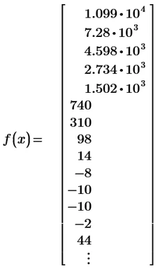

How to extract an element that has been defined as a range from a vector?
  • September 26, 2023
  • 1579 views

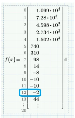

How to extract for example the 13th element from below?
Best answer by terryhendicott
The creation of x makes it a range variable not a vector of scalars.  An undocumented trick to turn the range into a scalar vector is to use inline equals in the definition.
September 26, 2023
Cornel19-TanzaniteAuthor
September 26, 2023
I have a question here: can this undocumented trick fail? And if yes, then when can it fail?
September 26, 2023
Never had the trick fail.  Here is the "correct" way
