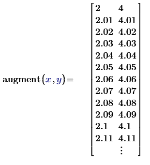

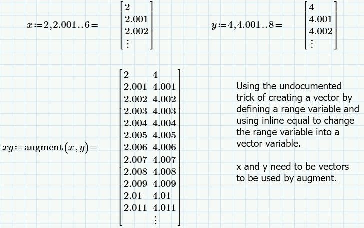

I want that x and y to be in a single matrix with 2 columns:

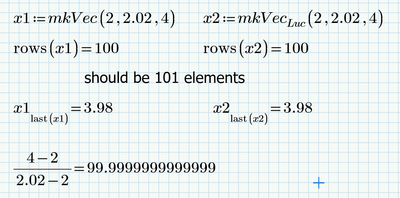

Nice idea!
Your approach works OK as long as "last" is not actually a member of the result vector
but it fails if it is
For the example given it works OK, though,
but the reason is a round-off error which forces ceil to return the correct number 401
Using floor(...)+1 instead of ceil(...) should fix it (unless we find an example with a numerical inaccuracy in the opposite direction)
EDIT: And the example wasn't hard to find. Both your versions (the orginal with ceil(..) and the suggested fix with floor(..)+1) fail and also my version fails 😞
A possible fix might be to to round to something like 7 decimals first and only then apply  floor(...), or trunc(...) .

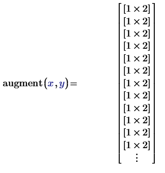

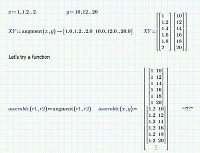

A range is not an array (neither vector nor matrix). All operations you try to do with them treating a range as an array is dangerous. In contrast to your example, here's what I get with Prime 7:
Instead of a vector of 1x2 matrices, I get a 2x1 matrix with two 6 element vectors.
Now a decent 'flatten' function should be able to transform either result into a 2 column matrix, but never the less, you risk to run into compatibility problems.
The assemble function shows how dangerous it can be (in Prime) to use ranges as arguments to functions.

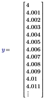

I finally figured it out how to do:
Firstly, x and y must be further displayed...
LucMeekes
(To:Cornel)

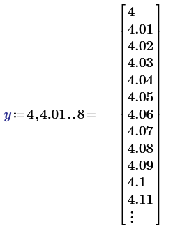

Note that you are using an undocumented feature, a trick that may at some point (future release of Prime) not work anymore.

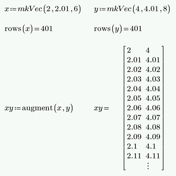

As Luc already noticed, you are using a convenient, but undocumented trick to turn a range into a vector.
Its not really a clever idea in Prime to make vectors and ranges looking the very same.

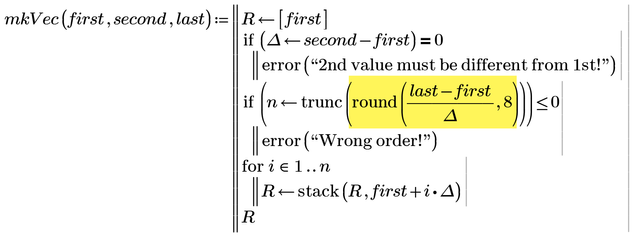

If you want to be on the save side you may create the necessary vectors using ranges (only used to index the vector elements, like
or you make use of a utility function like the one shown below, which accepts the very same arguments you also provide when defining a range:

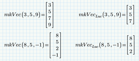

For those interested, the poor man's implementation of mkVec is:
gives:
And if you are fond of making mistakes, you can have it with error checking:
(To:LucMeekes)
Nice idea!
