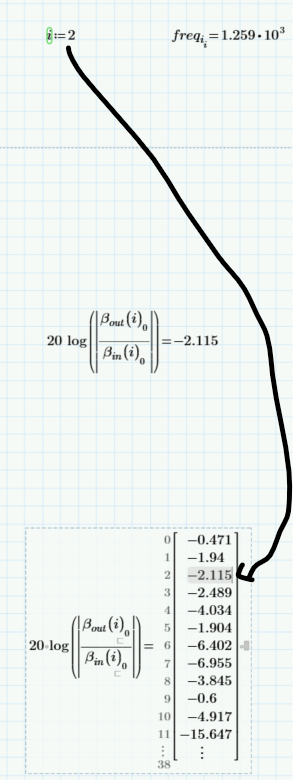

These examples are for each particular i:
But how to iterate through all values of i:

Yes, the second variant.
But look:
How to extract each i from the above two vectors?
24-Ruby V
(To:Cornel)
I don't understand what you are looking for!?
The values you calculate singly for i=4 and i=10 seem to match perfectly with the appropriate values in the calculated vectors.
I see no problem or error here.
Or could it be that you stumble across this age-old problem??
If that's the case you may have a second look at how I defined the vector(!) "ratios" in my answer above!!
Look:
I want to extract from the 20log() vector each i value:
Because look:
Compare the 2 vectors and you will see that they are different
So,
And from this vector I want to extract only the value corresponding to i=1:
Then if i=2:
And to put these values for each i into another vector:

@Cornel wrote:
Look:
?? See my edited answer above. Assign the 20log() expression to a variable so its a vector and access the appropriate element.
Or furmulate that expression as a function of i if thats more appropriate.
Not sure what you mean!? You use two different values for i. Of course you get two different vectors.
On the other hand I don't understand why you get vector like results anyway if you use a single scalar for i ??????
You should get something like
I used the sheet you posted last. The values are different so I guess you are using different data in your picture
I was expecting something like this to be in 20log() vector:
And so on...
I used the data and sheet you posted last and I have no idea where you would get these values from!?
When I do it, I get
and this perfectly corresponds with the first two values in the full vector we crated
