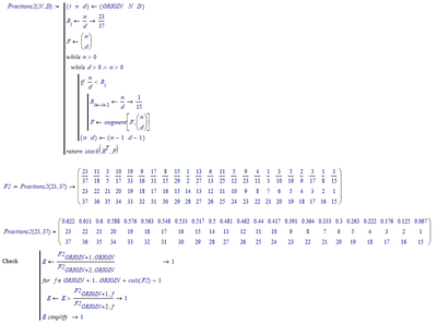

Hello Everyone.
Thanks in advance for your time and help.
   Best Regards.

OK, I see. How about:

I think you want Fractions2:

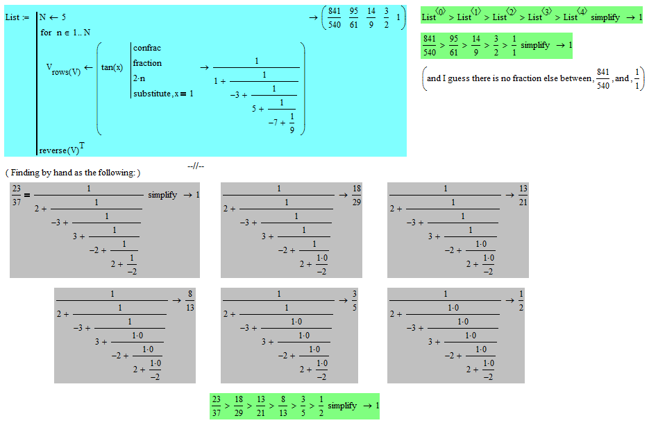

It seems my question is not clear, Luc. With finding by hand then :

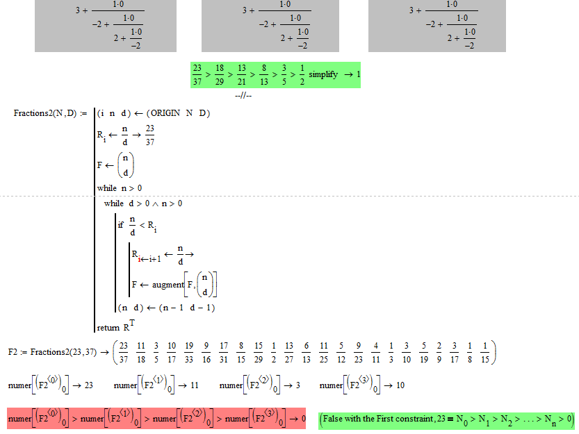

Luc, I guess I have been stated the three of constraints in my question is not clear. ( easily cause misunderstanding, especially the First constraint ) :

You are right, Luc. My question, the above, should be corrected as the folowing:

Luc, my question have been arisen from here :
Thanks again for your time and help.

tietjee
(To:lvl107)
From your last post I think you are looking for continued fraction.  Both Mathcad 15 and Prime a function to easily calculate continued fractions.
  confrac   will give a list of each of numbers in a continued fraction
  confrac,faction   will show the continued fraction
Enjoy

Thanks for your time, Tietjee. But I don't know how to create a continued fraction with alternate sign, so I have to create by hand as the following :
