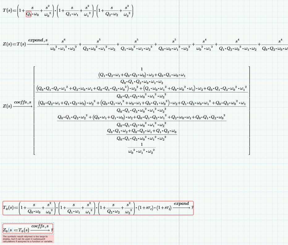

Hi
How can you minimize this kind of error:
The symbolic result returned is too large to display, but it can be used in subsequent calculation if assigned to a function or variable
I looked at the knowledge base questions and there are a lot of this kind of issue reported unfortunately they are quite hard for me to follow.
I see this error because the limitation of my computer or limitation of Mathcad Prime 6.0?
Can you provide and example of how to assign to a function or variable?
Below is what I am trying to do and it seems to work for T(s) and Z(s) but does not work for T0(s) and Z0(s) after I increase the complexity of T(s) a little more

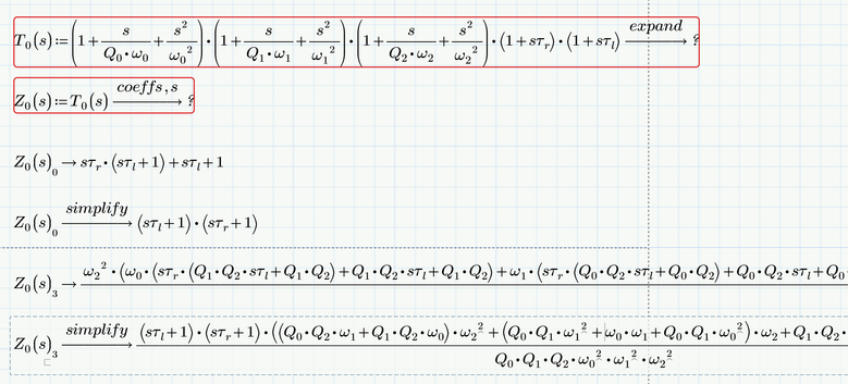

Yes, that message is annoying and there is not much you can do.
1)  Sometimes, when the result is a vector or matrix, it may work if you assign the result to a variable (or function, as you did) and evaluate the elements of the vector/matrix one by one
2) sometimes adding "simplify" or even "simplify,max" to the symbolic evaluation makes the expression small enough so that its allowed to be displayed.

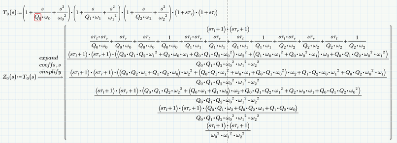

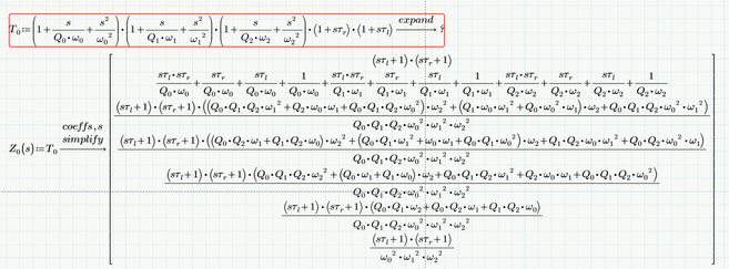

Here is a way to achieve the desired result. Note that it was necessary to turn T.0 from a function into a static variable.
You may also use "collect,s" instead of "expand".
(To:Werner_E)
OK, T.0 can also be a function of s if you put the "expand" keyword on top of the second evaluation
(To:Werner_E)
And finally here is what I was talking about when I wrote about evaluating the elements of the result vector one by one:

Thanks Werner_E, evaluating the elements of the result vector one by one is exactly what I need. Again thanks a lot for your helps

In addition to using the "simplify" command, you can define separately in a single constant every single compound constant as in the figure, moreover it should be "s ∙ τ" and not "sτ" which is considered as the name of a variable and not a product .
