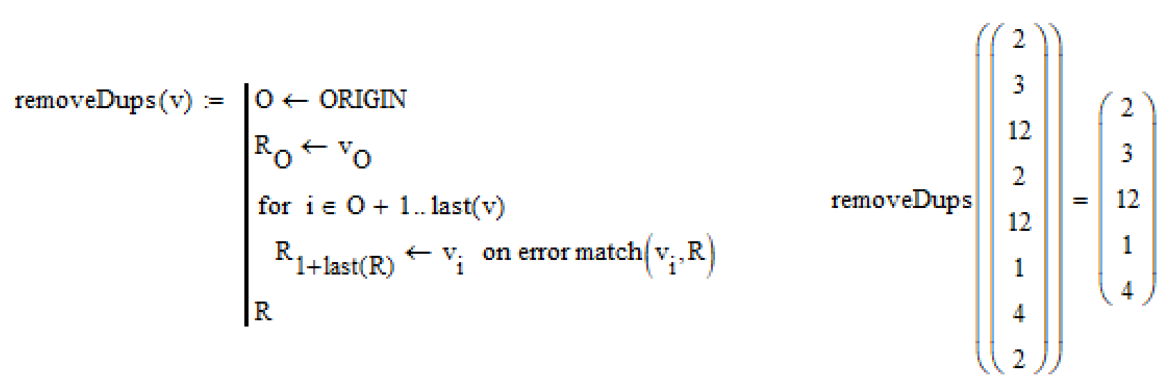

Here's another implementation:
Mar 27, 2018 9:43 PM UTC
Clever way, like it!

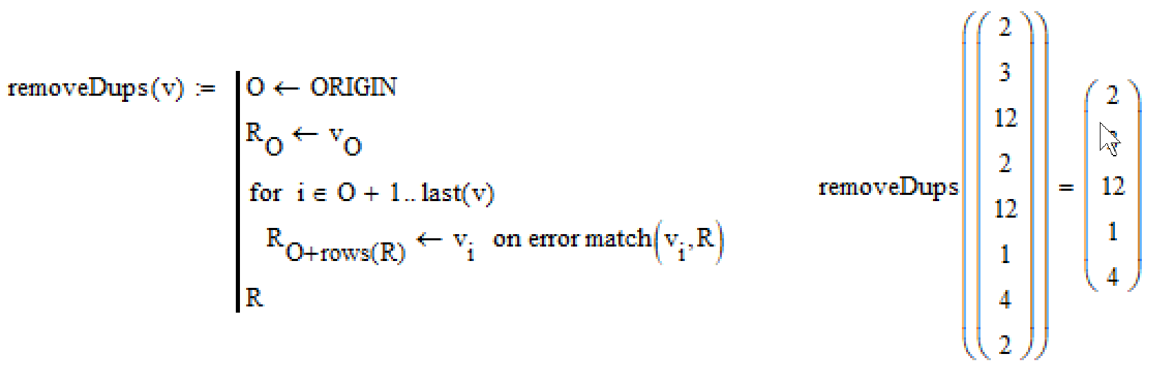

It inspired me to the following variant:
Its so much smaller in real Mathcad:

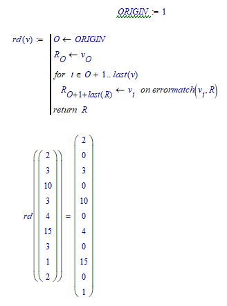

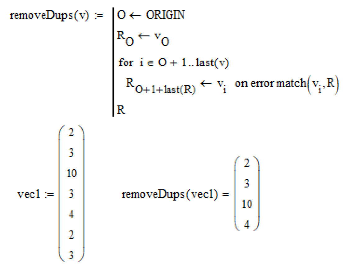

23-Emerald V
Mar 28, 2018 10:23 AM UTC
Werner
I'm not sure your implementation works for ORIGIN=1.
You have an O+ in the index of R when assigning a new member, together with using last(R); that adds another (empty, or 0=zero) with every addition of a member.
OK.... I'm sure it does NOT work as intended for any value of ORIGIN other than 0.
