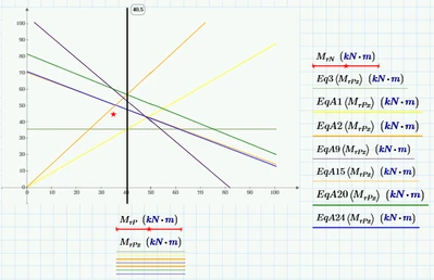

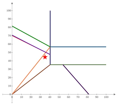

Hi. I am trying to set ranges of variables in a plot in Mathcad prime v.7.0. But it is really difficult for me. Can you give me some advice? Thank you so much.
1 ACCEPTED SOLUTION
Your goal is to limit the lines to duplicate the picture, right?
It may be possible doing so with a couple of range variables (I guess you would need four different ranges to accomplish the task), but I find it more comfortable to define new functions using the if-function to "plot" NaNs where you don't want to see the line.
I added Eq1 which was missing in your plot.
EDIT: Just for fun I added a way to achieve the same plot using four ranges.

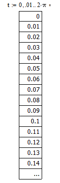

Just be careful not to evaluate the range variable, I have a bug where when I end the range variable for evaluating its array, it crashes everything below it related to it, including graphs. I can evaluate it separately and it works, but it shouldn't have to be separated. I have also run into problems with units in range variables causing similar issues. I am on Prime 7.0, unfortunately. I'm not a fan of any of the Prime series based on the hundreds of bad conversion crashes my converted MathCAD v15 and prior are causing. All other prior MathCAD versions work just fine when evaluating with an "=" sign after a range variable. Only Prime crashes.
I am not sure what you problem is!? What your "before" pic is showing would not work in real good old Mathcad as well!
A numerical evaluation of a function definition is not allowed - for good reasons!

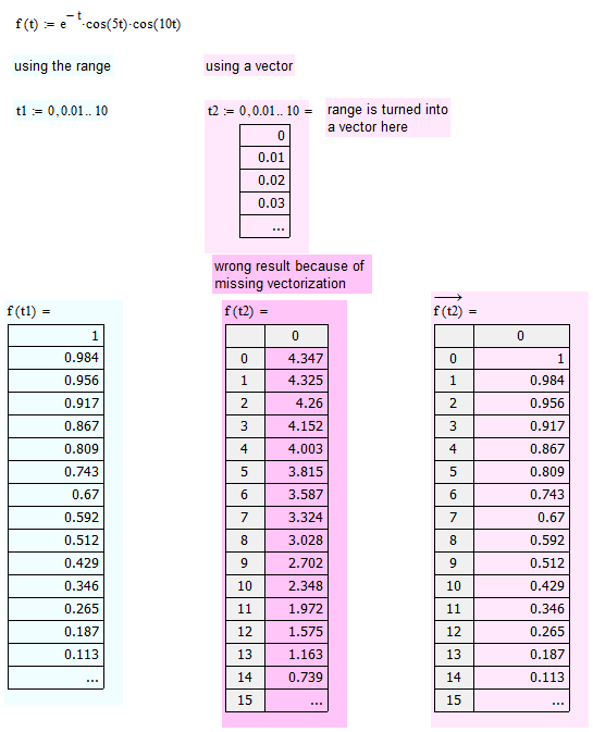

You should also be aware that if you define a range and follow that definition by a numerical evaluation, as you did when you defined "t", the range is turned into a vector! This is an undocumented feature and works the same in Mathcad 14/15 as well as in Prime.
That said you also should be aware that the results you get when you evaluate y(t) are NOT the results you might expect!
Because t is now a vector, e^-t is a vector, too, and the same applies to cos(5t). These two vectors are now multiplied and the result is a SCALAR (vector product)! This scalar is now multiplied with cos(10t) which again is a vector and thats the reason you get a vector result, but with values you did not expect.
The get the correct results you would have to apply vectorization when you call y(t).
You will see the very same behaviour in Mathcad 15, 14 as in Prime in this case.
So, no, this is not a bug, but just a matter of misunderstanding how Mathcad and Prime are working and dealing with ranges and vectors.

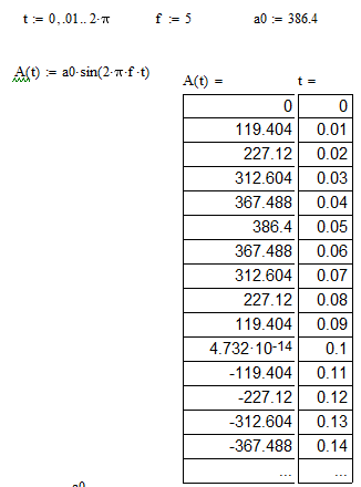

I have been used to the attached image for the issue I was having trouble with, because I was used to doing it the old way (v15 and prior).
It mixed the two images up, but on the left is what I started doing when they allowed the = sign to be done after the range variable. In my original reply, I mis-typed 'range variable' when I should have put the 'function' using the 'range variable', as I later realized. Below you can see how I now have been using the range variable evaluation, and on the right, the old way I did it to get an X, Y type of comparison next to each other.
I understand the mathematical difference of the variable vs. function, I had just done it more recently on new worksheets evaluating the range variable immediately after defining it, so I figured it would allow me to do the same after the function definition, similarly. Now I see my old worksheets had both next to each other but not immediately after the definition like I now do more regularly.
In the last pic you posted the results of A(t)= .. are correct, because the function A does not have elements where vector arithmetic would be applied and so Mathcad automatically applies implicit vectorization. But I would suggest using explicit vectorization everytime you want it to be done so you are on the save side. As seen in my last example you may get wrong results for some functions if you don't apply vectorization.
