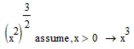

(x^2)^(3/2) = x^3 is true for x>=0 only, not for x<0.
And if x is non-real, the square root ()^.../2 has two results, not just one like x^3.
Mathcad takes that into account and will only simplify to x^3 if you tell it with the "assume" that x is positive (that implicitly also tells MC that x is real of course).

Ah, that helps. Thanks!
