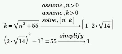

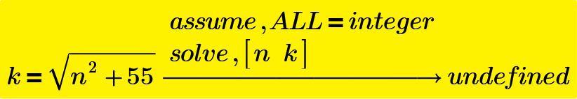

Mathcad never was the tool to solve diophantic equations (apart from an extension pack which worked only in a very early version of MC).
You get a result in MC15 but its in no way helpful:

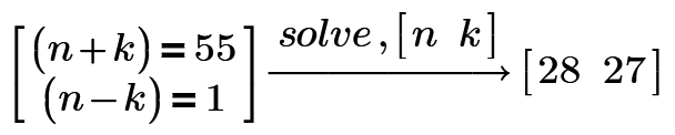

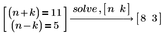

Mathcad 11/Maple:
and with
you get only the first answer.
Well, you can find the answer, but it's not really "solving"  . . .
